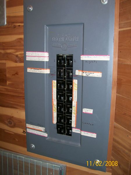

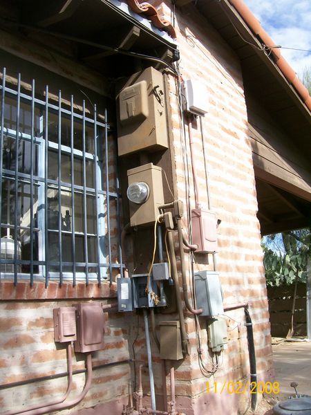

For most panels? This house is not a mansion, its about 3000 sq ft.
One pic is the exterior then it had 3 sub/service panels on the interior.
that mess was for one house Mark ???
Two questions:
Is that cedar in that one pic? Meaning, is that panel installed in a cedar closet???
Are those bars on the windows???
All houses in Tucson, in the Barrio, must have Bars installed, it’s a Code of the West thing Speedy. ![]()
there was a sad story here a number of years back about an older couple who died in a fire in their home because of those bars…they are getting less popular here now…
What?—bars or older couples?:shock:
I’m thinkin the bars Mike…:roll::roll::roll:
You think there might have been an electric add-on to the add-on, to the add-on ? ?
You think ???
Yes I really hate the bars also and disclaim them.
Yes it is in a cedar closet.
Yes it is all one house.

Here is some information about “Bars over Windows” that you might find useful.
Please feel free to add it to your data base for future use
{Mark be sure to provide this information in your report!}

R310.4 Bars, grilles, covers and screens.
Bars, grilles, covers, screens or similar devices are permitted to be placed over emergency escape and rescue openings, bulkhead enclosures, or window wells that serve such openings, provided the minimum net clear opening size complies with Sections R310.1.1 to R310.1.3, and such devices shall be releasable or removable* from the inside *without the use of a key, tool, special knowledge or force greater than that which is required for normal operation of the escape and rescue opening.
