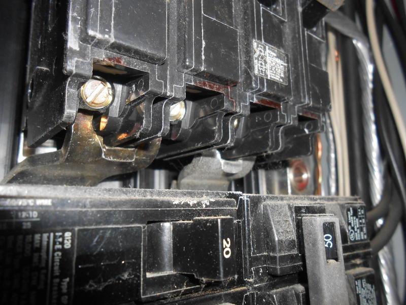

Is the discolored bar under the main breaker a problem? Is this from overheating?I did not see any other evidence of burning in the panel. this was in a townhouse, 150 amp breaker. Gas furnace, electric water heater and range. No AC Thanks for any help.
It would be fun to see that one in a thermal image I would suspect a loose lug or breaker going bad
I have to agree with a loose lug. I bet if you pull the meter and check it the lug wasn’t torqued to specs and also there’s no paste on the ungrounded conductor.

Yep i bet a bad breaker
David, even without IR camera, I make it a habit to hit the all different circuits in the panel with my IR thermometer. I have found defects this way.
