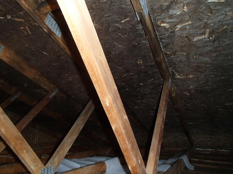

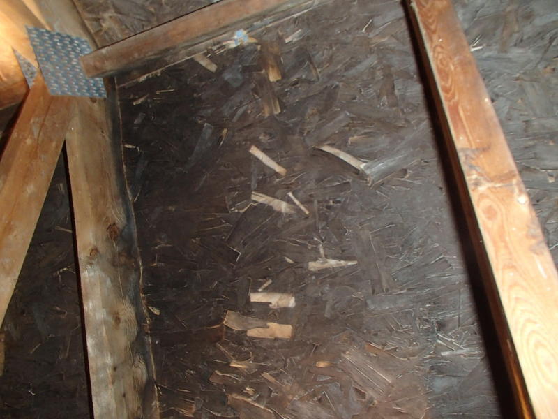

It is normal to still have the discolouration visible after a professional remediation?

Yes, but no where near that much

No, they should have soda or ice blast it off. Then it needs an antimicrobial sealer applied over top. If the roof covering is not in great shape, it is more economical to replace the sheathing.

> [@mgratton](#):
Yes, depending on the product used and what is meant by “professional”. It’s ugly and would better deal with future perception of an imaginary problem if they removed the staining. Paints and sealers are not recommended because they change the rate of equilibration of the material and can cause moisture to become trapped. Check out “MMR”, it removes staining ridiculously fast.

IICRC S520 recommends sealing. They make clear antimicrobial sealers. You want the wood not to soak in moisture, that is why it is called sealing. The wood is dried before any sealer is added. The sealer keeps the mold from growing back. Some mold growth will always remain in the wood grain, thus that is why sealing is important.

> [@jbraun](#):
That would be an overstatement. The IICRC S520 you mentioned says on page 21, 5.8.1 and several other locations:
> Source removal of mold contamination should always be the primary means of remediation. Indiscriminate use of antimicrobials, coatings, sealants, and cleaning chemicals is not recommended.
It also reiterates the concern regarding sealants actually causing a build up of moisture on page 22, 5.8.2:
> Antimicrobial coatings and sealants should not create a vapor barrier that could lead to a buildup of moisture, and possibly contribute to a future microbial or structural problem. Products should demonstrate reasonable permeability…
It goes on in section 5.8.2.1 and many sections thereafter to make clear warnings about using sealants which encapsulate growth, create a vapor barrier or are used in place of moisture control or adequate cleaning.
A better way of describing the IICRC S520’s mention of sealants would be to say it recognizes it may be considered in some situations but it does not promote it.
> [@jbraun](#):
> **You want the wood not to soak in moisture** , that is why it is called sealing. The wood is dried before any sealer is added. The sealer keeps the mold from growing back. Some mold growth will always remain in the wood grain, thus that is why sealing is important.
I’m not sure where this information is coming from, but it’s not from the IICRC S520 you mentioned. As quoted above, in the few instances where sealants would be used, they are _supposed_ to be permeable. They are specifically NOT supposed to create a vapor barrier which would prevent moisture exchange. This is stated emphatically along with repeated statements discouraging the improper use of encapsulates throughout the IICRC S520. (e.g.Pages 21, 22, 46, 48, 117, 120, 121, 175, 177) I hope this helps everyone.

Question…wouldn’t remediation include proper removal of the staining?

> [@thession](#):
For most mold remediation contractors, yes. It makes sense to do it since stains will affect people’s perceptions whether there is a problem or not, and people’s perceptions can affect the value of the house. But it’s not an issue of what is proper. Stains are just that, stains. If the moisture issue is addressed, stained wood has the same potential for mold growth as unstained wood.
