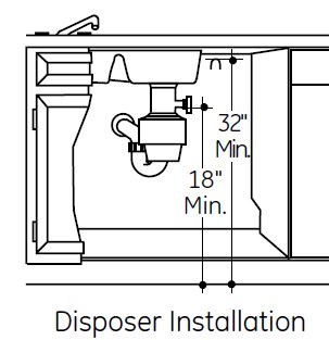

GE Consumer & Industrial
Appliances
CAUTION
An air gap MUST BE USED if the drain hose is connected to waste tee or disposer lower than 18" above the floor level. Failure to provide the proper drain connection height with an air gap or 32" minimum, high drain loop will result in improper draining of the dishwasher, which may cause damage.
PREPARE DRAIN PLUMBING
Drain Requirements
Follow local codes and ordinances.
• Drain hose must not exceed 10 feet in length.
A high drain loop or air gap is required. See below.
Drain Method
The type of drain installation depends on the following:
• Do local codes or ordinances require an air gap?
• Is waste tee less than 18" above the floor?
If the answer to either question is YES, an air gap (Method 1) must be used. If both answers are NO, either an air gap or a high drain loop (Method 2) may be used.Dishwasher install to disposal.jpg
I don’t think it’s a stupid rule. I have seen the results of “muck” from disposals backing up into the dishwasher drain line. It’s pretty disgusting. It also creates a horrendous smell in the dishwasher.
A properly installed air gap device eliminates the possibility of anything getting back into the drain line. Not allowing the connection to a disposal also eliminates this potential. So I agree with both “rules.”
A high-loop is only effective as long as the sink/disposal drains do not back up. If the sink happens to flood above the high-loop, contaminates will make it back into the line.
Jeff ,if you read my excerpt from GE above would you agree that ignoring local code voids the warranty?
(See bold text.)
In almost any instance, when the manufacturers installation requirements are ignored, their warranties are void.
So yes, I agree. Improper installation of the drain line may very well result in voiding of the manufacturers warranty.
