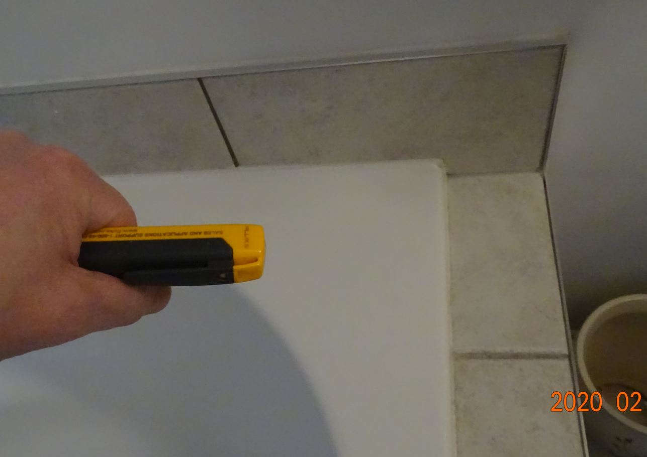

Do you call out Negative slope of the tub ledge?
Get rid of that level immediatly.

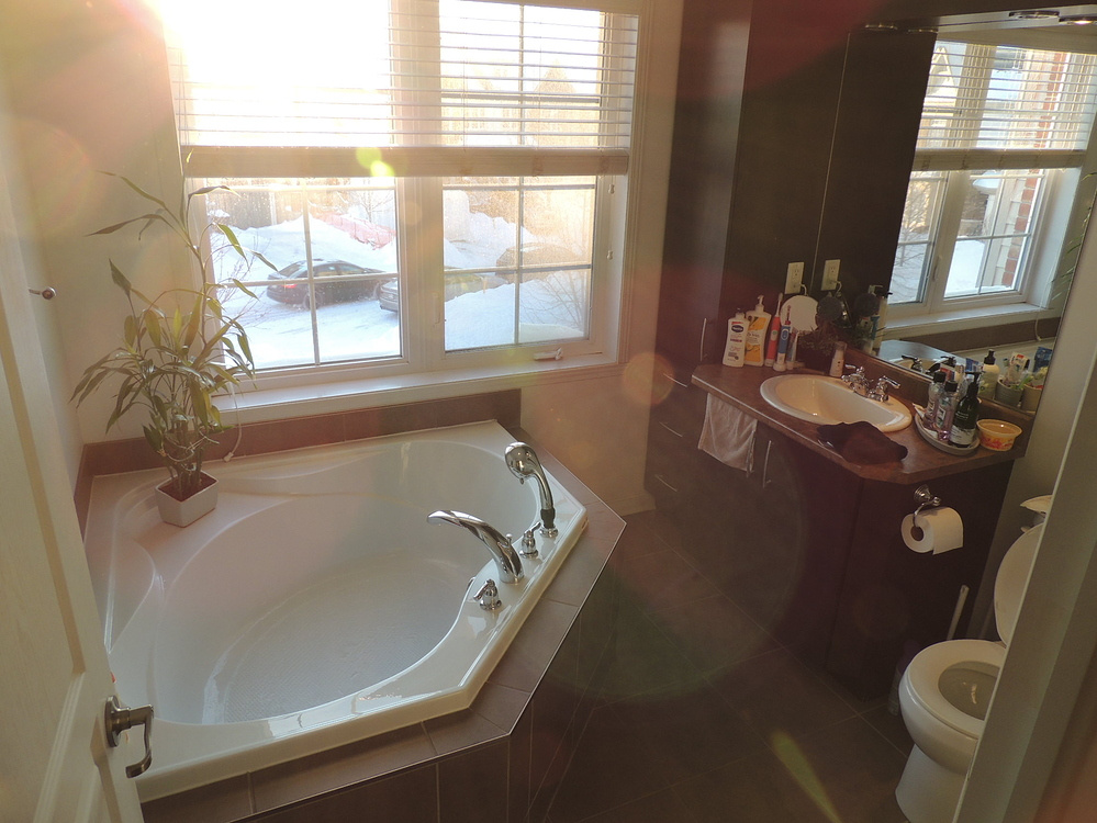

My concern would be whether or not that window is tempered.

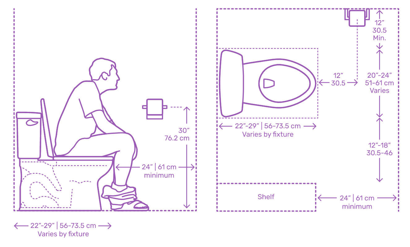

I would definitely write up that toilet paper holder for being mounted the wrong direction, too low to the floor, and too far back to the wall. It should load from the front, be 30" off the floor and 12" in front of the toilet rim. You are just asking for a back injury being forced to twist around and maneuver in that tight space. Furthermore, clearances around the toilet are too tight on the sides and from toilet rim to door frame. A full bathroom renovation is required.
I would put this in my report:
“Safety Hazard - Installation of the toilet paper holder is dangerous and clearances around the toilet are not adequate or safe. This should be repaired by a licensed plumbing contractor to NKBA and local standards before using this bathroom. I recommend getting 3 quotes for demolition and renovation prior to the expiration of your objection period. Don’t go with the lowest price. Get the guy who is #1 in the #2 business.”

I’m so embarrassed now … In 35 yrs of inspecting I’ve never reported this. My own is that way. Where would it go IF it was sloped to the tub lip ??? Not a concern to me BUT seems I’m probably a soft HI.

Its quite amusing reading the posts from inspectors that do not disclose what is possibly attributing to ceiling drywall damage below a bathroom.
It is quite amusing reading the posts from inspectors that do not disclose how bath tub caulking deficiencies possibly attribute to ceiling drywall and other possible damages.
It is quite amusing reading the posts from inspectors that do not disclose if a bath tub was installed correctly.
To think a simple level would help disclose this. Hmm. Interesting.
Here is a case where tub tile surround gradient was reversed and caulking not effectively sealed to all surfaces. The tiles were negatively sloped to the wall/tub intersection and pooled at the curb. The possibility for bulk water penetration was high.
Recomendtionation: Recaulk all surfaces that abut the tub.
You would measure from the finished flooring to the top of the inner window sill.
If/When under 24" Safety Glass and EERO is required.
Not sure where you are coming up with 24" for a window in a tub enclosure.
Wet Areas
The higher risk of slips and falls in wet areas means most glass located in bathrooms or near a hot tub or sauna must be constructed from safety glass. All glass in the bathroom or around a hot tub or sauna must consist of safety glass if the bottom edge is less than 60 inches above a standing or walking surface, such as the shower floor. In outdoor areas around a hot tub, all glazing must be constructed from safety glass if the bottom of the glass is less than 60 inches above the walkway and also within 60 inches of the edge of the water, according to the IRC.
He’s mixed up as usual.
I was not referring to hot tubs or saunas.
The tub the OP posted looks like a universal tub model. Not a left hand or right side entrance tub.
The window sill looks more than 24" inches height.
R308.4 Hazardous locations. Link from [Gerry Beaumont]

  5. Glazing in doors and enclosures for hot tubs, whirlpools, saunas, steam rooms, bathtubs and showers. Glazing in any part of a building wall enclosing these compartments where the bottom exposed edge of the glazing is less than 60 inches (1524 mm) measured vertically above any standing or walking surface.
