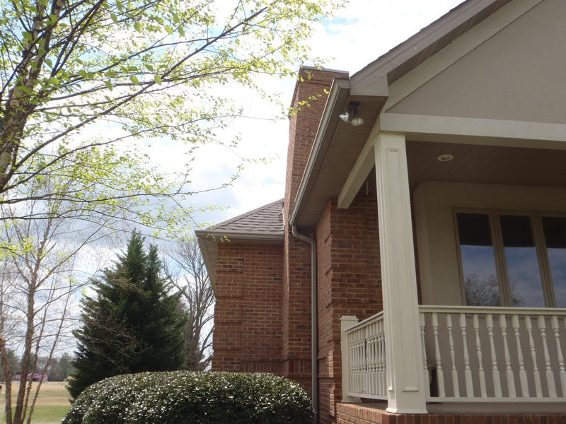

Winner gets a dirty pair of my skivies. 😛
do you see the problem?
 ![1637 Sd 072.jpg](https://global.discourse-cdn.com/internachi/original/3X/1/b/1bdaa8bad064bf397fea2b9639af11bbde1bef6c.jpeg)

What’s with the one different spindle on the side of the porch?

Did the brick mason forget his level when he got above the roof eave? It is a question, not an answer…no prizes please. :shock:

> [@lkage](#):
Getting toasty!

> [@lkage](#):
Smaller bricks on the back side.

No downspout on portion of rain gutter?

Chimney leaning

The chimney is twisted and leaning. It also looks like the bricks are discolored behind the downspout. I am on my phone but it looks like the bricks and soffit don’t line up.

Flood light being on the wrong side of the soffit…Just saying that it may be subject to moisture.
Cant agree with the chimney lean without a better photo.

Chimney leaning (possible bad pic quality) and missing kickout flashing at chimney…

two different kinds of spindles on the front porch, not a defect, but a cosmetic issue, unless you’re a heartless, RE agent-hating deal killer…

I saw the leaning chimney as well.

Interior pot light on the porch.

The chimney had a small horizontal crack right at the roof line.
A cathedral ceiling was exactly where that spot was, so no loooking at it from the attic.
I have a fealing they somehow did not brick it fully on the back side, or used the roof as the support structure.
Kinda scary.

I thought my eyes were playing tricks on me. The leaning chimney mixed with the lines of the porch and hip of the roof made it almost look like an illusion.

A bead of structural silicone will work in that crack to prevent further tipping, deal killer. :roll:
