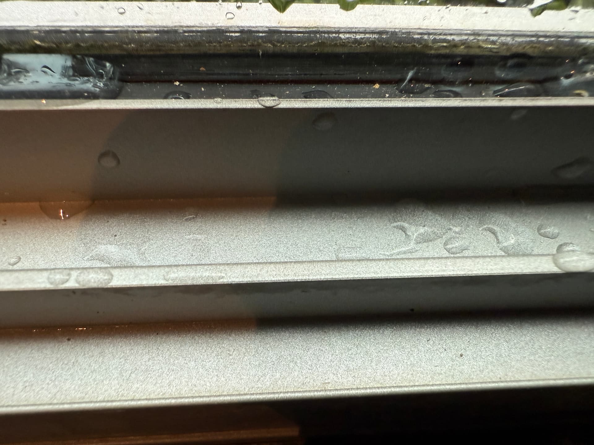

Has anyone seen this issue?
NOA Approved windows without weep holes.
I don’t think weep holes are your problem here.
Agreed, weep holes would be on the exterior. It almost looks like one of the panes is gone to me.

I would expert the top of the door frame to be covered and sealed. Look at the dirt and soil inside the pocket. There should be a way for water to weep out. But how did that soil or dirt get there?
Looks like the seal is gone on metal crank casement thermal window pane. The window is sweating.
Casement windows “sweat” from condensation.
As for weep holes in the window frame assembly. There is a drainage system assembly would be inside the bottom window frame. The weeping holes would be on the exterior and inner or mid frame.
Closed blinds, curtains or exterior window treatments can trap warm air and exacerbate the issue by preventing proper air circulation.
Is the recessed window framing assembly able to circulate or are the curtains or window treatment blocking air from circulating within the recessed area?
Not all windows have weep holes. For us as home inspectors, we don’t diagnose the absence or presence of weeps as the problem. We just report what we see and we see water on the inside of the window. It’s supposed to stay on the outside.
