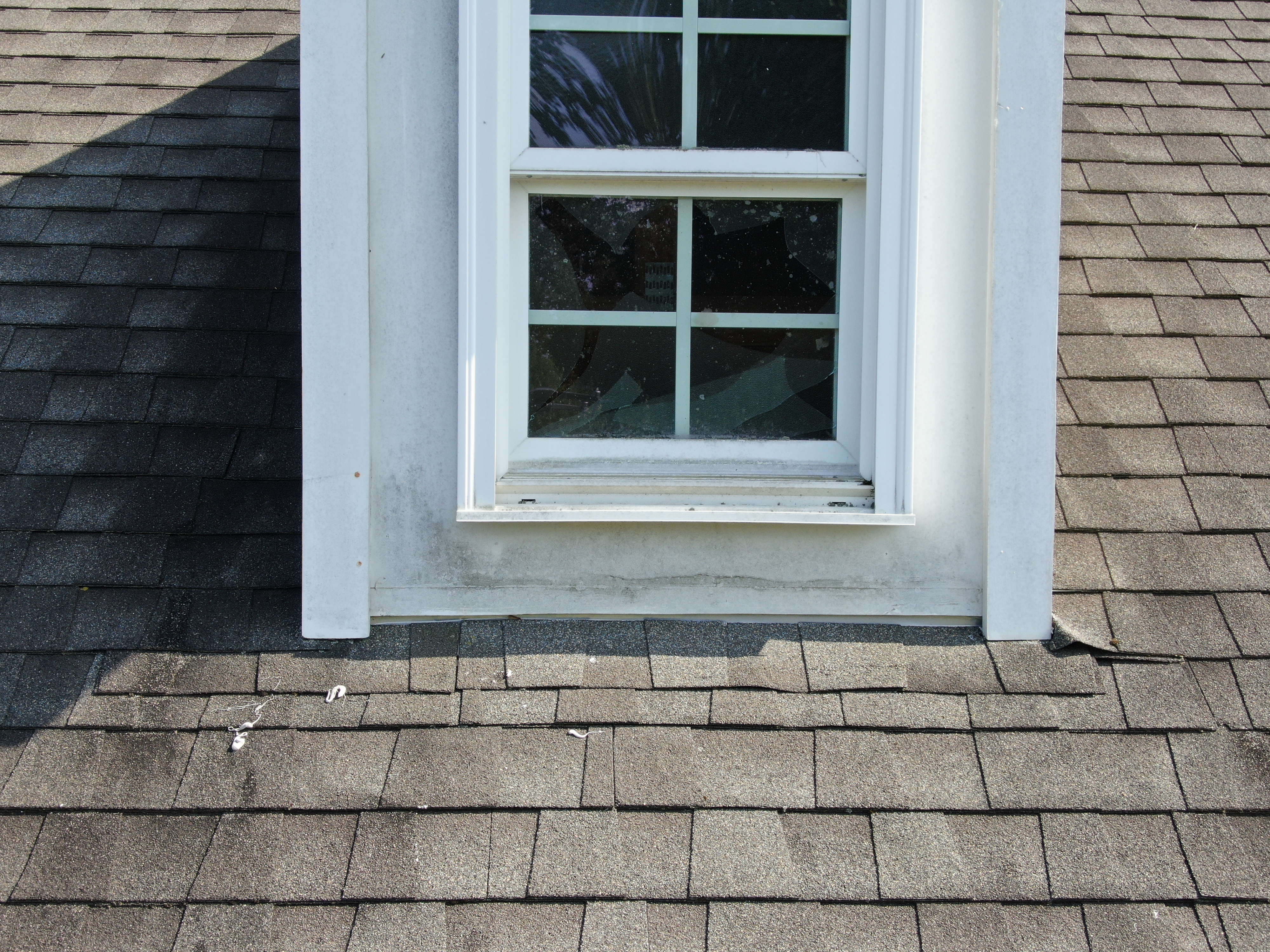

Home I inspected yesterday. Built in 2008. Seller stated on seller disclosure she experienced roof leakage during sever snowstorm in 2018. Did not address it at the time. States it was an isolated incident. Three dormers, three leaks directly below the dormers. I reported it as defect requiring correction, owner trying to hold firm on not addressing it as anything other than cosmetic repair to the ceiling.

I was the property manager for a condo association for awhile. We had one house that would have a roof leak every few years in the same spot. It could rain every day and not leak but under just the right circumstances where the rain was coming down hard enough and the wind was blowing in just the right direction it would leak. It took awhile to figure how the water was coming in but it ended up coming in by defying gravity. This may be the case here of the owner thinking it doesn’t leak because it only did it that once.
Seller wants to stand by this as an isolated incident, incurred during a heavy snowfall. Someone told her it happened due to an ice dam forming then melting. From my experience, if an ice dam had formed and melted it would not be coincidence to leak right at the window. The window should be weather tight (non-heated, non-insulated attic space). Weep holes in the lower window channel are open. My opinion is if it happened once, it will happen again, the installation requires further investigation and correction as required.

Thanks for the responses. I’ve suggested to the buyer to bring in a roofing contractor for further investigation and consultation. My personal opinion is, the flashing appears to be good, there is step flashing installed. I think the primary issue is the installation of a double hung window in that location. A fixed window, completely sealed would provide the architectural detail while providing a weather tight seal.

“My personal opinion is, the flashing appears to be good, there is step flashing installed.”
Apron flashing??? Discoloration around the bottom of the dormer siding to roofing junction.
There is apron flashing installed, course of cut shingles are cemented down for decorative purposes. Discoloration appears to be dirt. I’m assuming the dormers are prefab’d? I talked to the buyer, they are going to try to work something out with the seller.

Update, after further discussion seller agreed to bring in a contractor, reflash the dormers and repair ceilings where there was evidence of prior water damage.
Joseph, in each of the photos it looks like globs of white caulking on the shingles beneath each dormer. This may indicate some amateur repairs were attempted and the seller isn’t being truthful. I’d advise the buyer that the presumption should be that the leaks, while they may be intermittent, are probably ongoing. Also, since the leaks are on all three prefab dormers it suggests the problem is with poor installation, making it more likely than not that the leaks are from improperly installed flashing.
