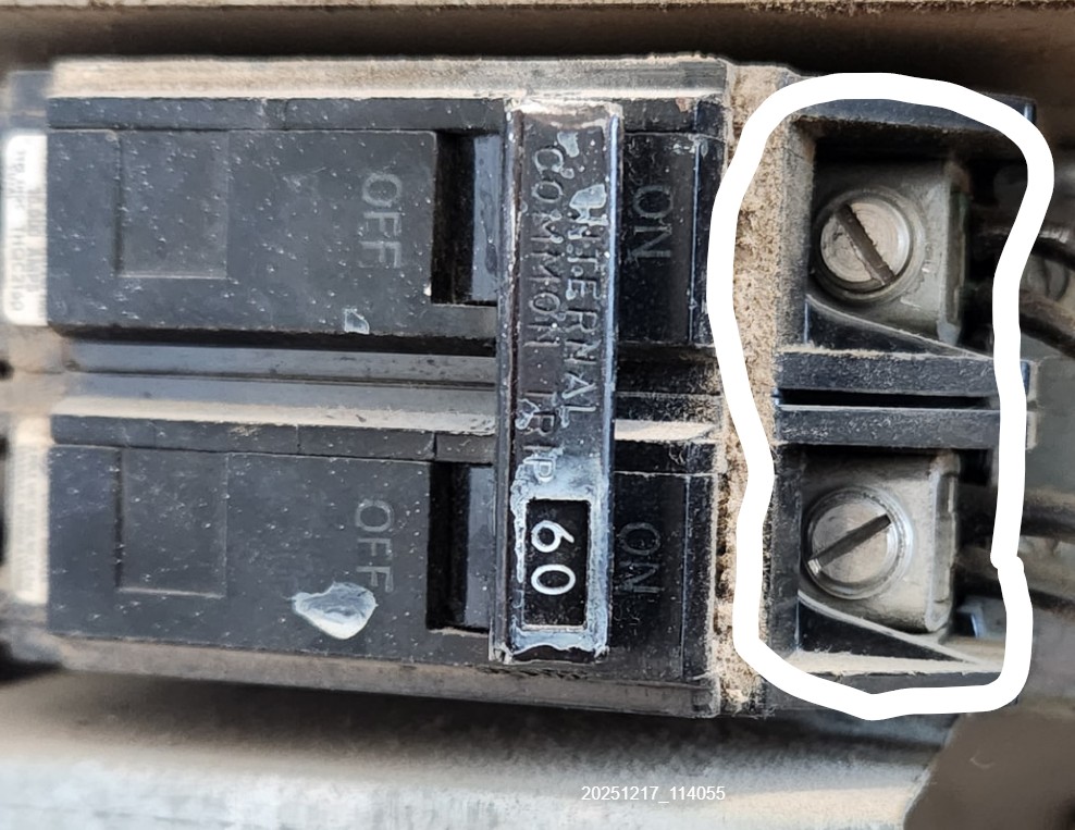

I cannot tell the age of this furnace as the label has been removed but I’m pretty sure it’s '70s maybe 80s. It looks pretty original inside but the breaker has two double taps and I’m not sure how I feel about that. I don’t know the brand of breaker what are your thoughts
Double taps not allowed. 2 #12 or #10 conductors on a 60 amp breaker is a BIG NO!
Are those factory conductors or are they field installed by a sparky?
Are you sure that those are double taps? They look like pressure plate terminals that are designed for two conductors.

  1. It is integral to the equipment.
  2. The terminals look like saddle clamps.
  3. Assuming one and two above are false, you have ask yourself, and explain to the customer what the real life consequences are. Can you do that?
Double taps on breakers are one of the least consequential deficiencies you can find in an electrical system. In the event of a complete failure of the connections, maybe the breaker will be damaged enough that it would need to be replaced. No one is going to be hurt. Nothing is going to catch fire.
The most you will ever hear, that is anywhere close to defensible, is that the manufacture says not to or the NEC says not to. Our customers deserve better than that.
Both the manufacturers requirements and the NEC are so broad in scope that they cannot possibly cover every conceivable installation. There sometimes comes a need for some common sense. This is one of those times.

Tapping a single breaker terminal twice is a no no in most cases, unless done during manufacturing and not in the field.
Moreover; those circuit cables do not look 4 AWG copper, or 3 AWG aluminum.
If a breaker or lug is not listed for more than one (1) conductor, double tapping or double lugging violates code.
Those are factory connections. The unit was tested and listed that way. Nothing to report.
Exactly. Some better photos would likely confirm that these are not field connected conductors and that the NEC does not apply so no issue to report.
