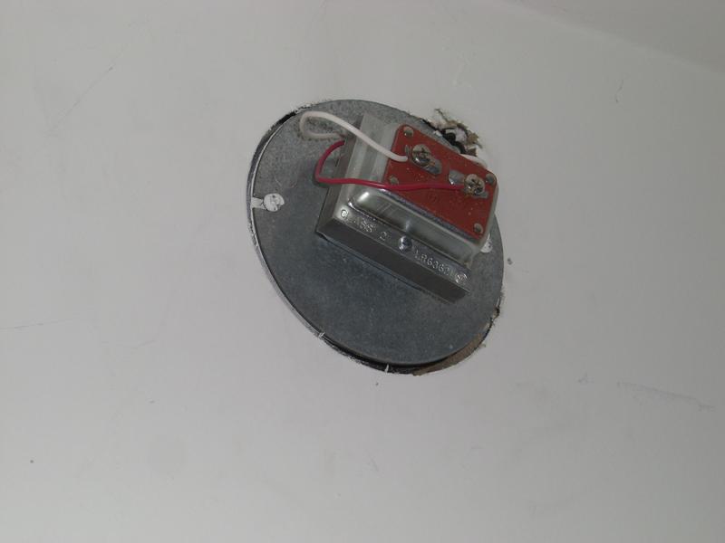

Another question. After seeing the picture of the transformer for the doorbell posted, shouldn’t these transformers be mounted somewhere that someone couldn’t come in contact with them very easily or even enclosed in an electrical box? Just asking. I have seen them mounted in the crawl spaces in proximity of where the front entrances are. I’m attaching a photo of one that I found up in a linen closet inside a home that I inspected.
Thanks in advance for the answers…
Please advise,
Steve
Steve,
Doorbell transformers are normally attached to the outside of the electrical panel. Never inside.
If you find one elsewhere throughout the home, they are fine. They’re low voltage.

Yep. That’s a simple doorbell transformer.
