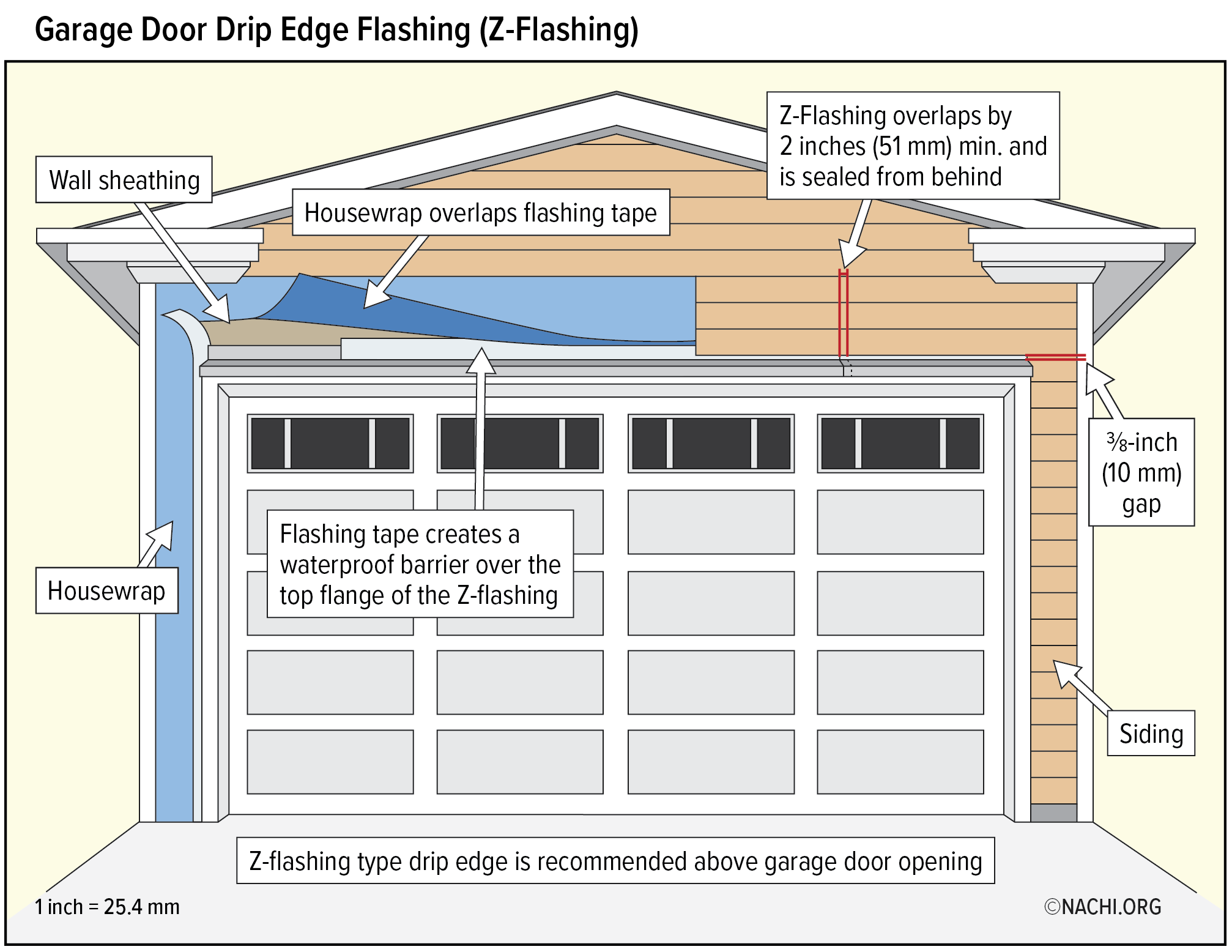

Draft image: Garage Door Drip Edge Flashing
I’ve attached a new draft image to preview, before finalizing. I’d like to hear any valuable feedback from the forum. Thanks for your help!
Many garage doors are wider that the standard 10 foot metal flashing, so sealing the overlap is also recommended, especially if the flashing is bent in a Z shape with 90 degree bends.

The flashing is called drip edge flashing, head flashing, and drip cap flashing; all in the same illustration. In my area, we call this z-flashing. Drip edge flashing would be for the roof.
Thanks for all the info. Image has been updated, hit refresh.

I am a bit confused by the head flashing. The detail is fairly simple, there is no additional flashing applied. The Z-flashing goes behind the WRB and the cladding. Viola!
Same here.
Z-flashing over a garage door is pretty much the same as Z-flashing used for a window or exterior door, with the dimensions of the flashing itself being the only variable. There’s no need to add additional or head flashing.
It’s as simple as the graphic that @bcawhern1 shared….
Image has been updated. Hit refresh
Is this better language for the image?
Thank you
I would reverse the color of the house wrap and the flashing tape. I would add as much contrast as possible. The z-flashing does not stand out against the door design (perhaps a red or dark brown door?). The language is ok, IMO.
It appears the “head flashing” was replaced with flashing tape. :thinking: Can’t say I’ve ever seen that done in these parts either. :person_shrugging:
What I do see regularly around here however is the Z-flashing extending beyond the side trim by at least 1/2” on either side. This might not be typical nationwide though.
Agreed. Flashing tape is typically black or have blue labeling and most house wraps are white. Swapping the colors would make the image have more of a “real world” appearance.
Flashing tape should be installed “shingle fashion”… vertical legs at the sides should be installed under horizontal segments above openings.
