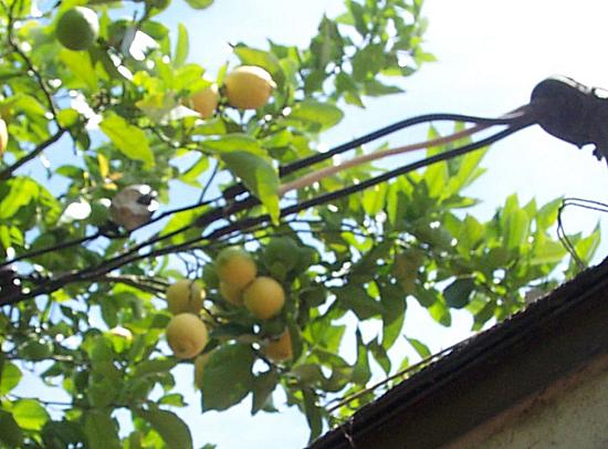

Drip Loop?
Originally Posted By: bwiley
Is this an acceptable electric entrance to the service mast?
![](upload://aTcPdEHIBByVHPGurNKqfYdlxWv.jpeg)

Originally Posted By: pdacey
It’s a drip loop alright. Depends on where you want it to drip. icon_lol.gif

Originally Posted By: Mike Parks
No
230.52.
Mike P.
Jeff
Use 230.24.
Mike P.

Originally Posted By: jpope
Mike Parks wrote:
Jeff
Use 230.24.
Mike P.
Mike,
I'm one of those HI's that doesn't own or carry a copy of the NEC ![icon_redface.gif](upload://f7DX2EWhmUfsDapWaYT3oJHMCj1.gif)
Can you give me a quick synopsis of the section you quoted?
Jeff
Sorry for the late reply. I have been busy.
The conductors shall enter in an 'upward slant'.
