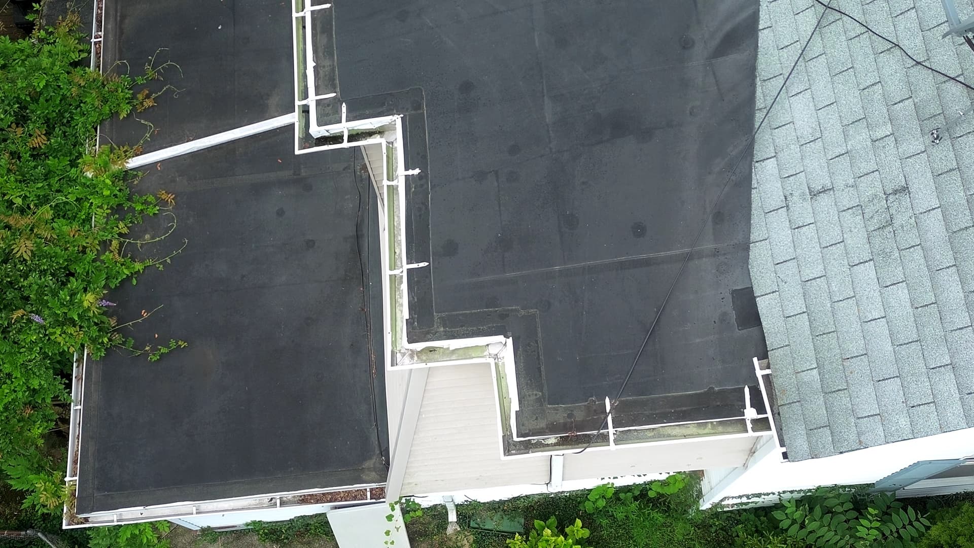

Yes, those are better images. The others were nearly useless.

Is that hail damage spots?
Very likely. we’ve had hail twice in the last year, most recently 8-4. Roof is 25-30 years. House I grew up in built in 1911.

That’s a different drone that i havne’t been able to fly because I crashed it and a motor burned out. I’ll be getting it fixed and using for inspections. The quality is even better than what’s shown because I didn’t have the SD card in that drone. Those pictures are of my own house.
