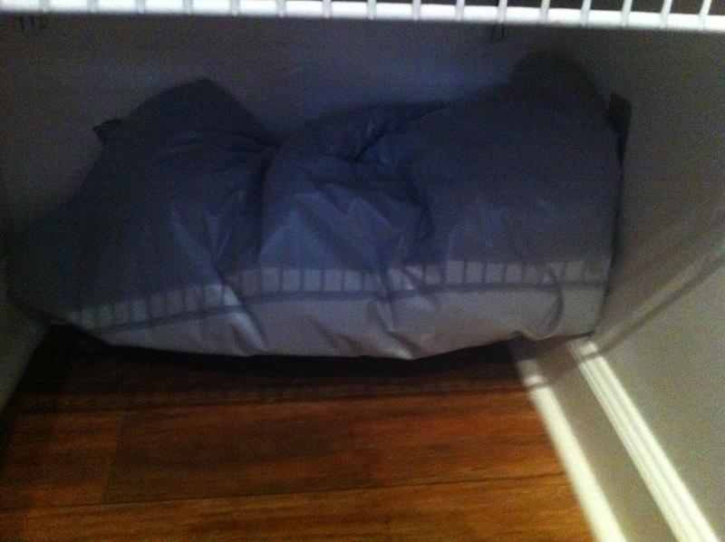

Hi All,
My apartment maintenance people wrapped the duct with some insulated cover…i am technically not aware about it but from their conversation i got to know its some insulated sheet which they normally use to wrap water heater.(Pic attached)
I want to know ur opinion about the same would that help resisting the heat so that the pantry wouldnt be hot.
Thanks
  1. Should be fine.
  2. How often do you use the dryer, once or twice a week for 30 minutes?
  3. You should never store food that can spoil if exposed to heat (butter, milk, eggs, etc., in a pantry anyway.

Sounds like the dryer exhaust is leaking. That would be bad, hot moist air is not good for dry food products or building products. Put a lit candle close to the duct, leave the pantry door open, start the dryer, if the candle flame blows around, the dryer duct is leaking and should be fixed. If it is not leaking air, it should be OK for the food you are storing in the pantry.
