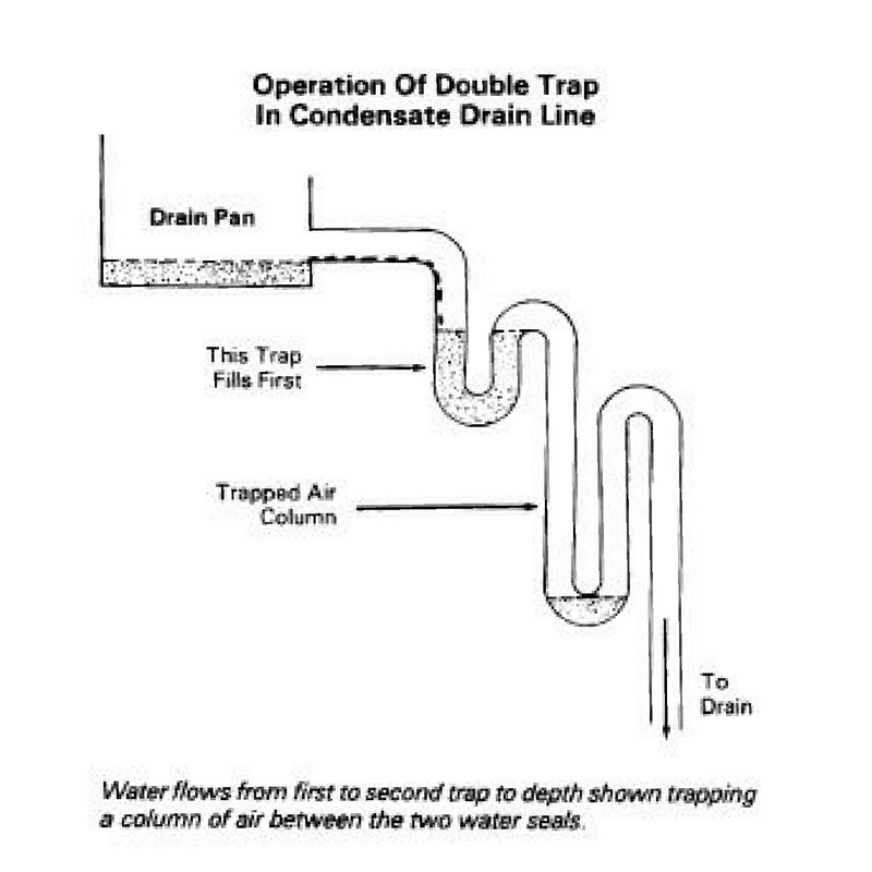

Ok, so I did some more digging and came up with 2 separate “official” answers. In the 2015 IPC section 1002.1 the very last sentence states “a fixture shall not be double trapped”. Ok, fine. I read elsewhere that each “well” of a kitchen sink may have it’s own trap and discharge into the DWV pipe via a Y fitting. (can’t find the code source to quote, didn’t save it I guess. my bad.) I guess it’s all on how far one digs into the overlapping codes and how one may interpret what is written.
So in this particular situation, IF there was an additional trap on the horizontal leg after the Y fitting, it would be considered a double trap. Hopefully this understanding is correct…

Just a FYI this is not a double trap set up.
After I did more reading, I kind of figured that was the case. If there would have been yet another trap for the sink only, then it would be. The whole set up could have been done with one trap I think if the disposal was rotated or just put on the other side of the sink…
NO! To simplify all the gobble-dy-gook being posted… 2 traps may not be installed… IN LINE OF EACH OTHER… on the same horizontal run!!
Hello JJ, Is it getting cold in your neck of the woods yet?? I have figured out the whole in line thing. This is where code language can get confusing since a double sink with 2 drains could be considered a single fixture. It’s all in how you look at it and prolly how bad the brown bottle fog is from the night before… LOL… Thank you, btw…

Hmm, not sure what to make of this. Doesn’t seem right to me. And what’s the purpose? Can this be an issue? Seems like standing water would eventually leak out from the first trap.
You are correct!
