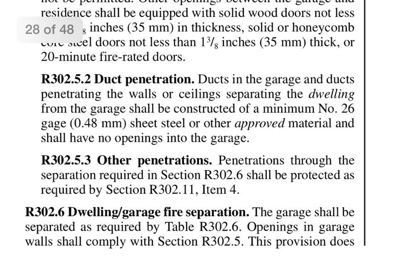

Ran into a house today with duct work going through the garage from one sise of house to other. What if any are your narrative suggestions. I know no registers are allowed, what about fire rating requirements for duct? Thanks for the help.

http://www.nachi.org/attached-garage-fire-hazards.htm
