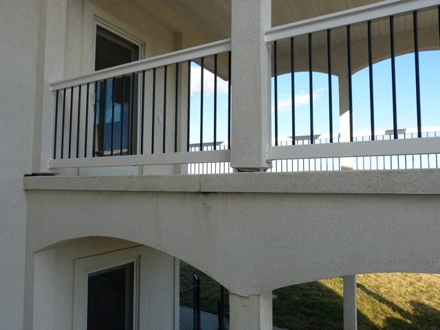

Home had some cracks under windows, on chimney flu and along one side. I called it out as needing further inspection by a qualified EIFS professional that will require invasive procedures to insure there is no issue inside the cavity or wall. Stating poor installation issues on some projects that have resulted in major issues in the past.

i attempt to identify the crack(s) cause
seldom do in the field cracks appear without impact damage or structural movement
the latter requires repair/stabilization before the EIFS is repaired
with most EIFS cracks: i probe for moisture & structurally sound substrate & framing materials, when moisture is located: painter tape or spray paint mark out the area requiring invasive examination to factually determine the extent of damage & the EIFS repair contractor tears off and replaces all moisture affected materials to whatever extent is required
a considerable amount of EIFS damage i see occurs from day one of the installation and irrigation spray head placement adjacent to walls, doors & windows. the most basic mfr instructions are not followed, omission or improperly applied flashing and sealant joints
as with any exterior coating materials deferred maintenance must be avoided
dow & most mfr have EIFS restoration guides available on line
Any visible cracks. around penetrations, protrusions, abutments, angle charges, applied materials, I use my IR for visual verification and my Delmhorst EFIS 10 inch probes for moisture analyses.Any visible structural stress patterns or clear visual indications I take HD images.

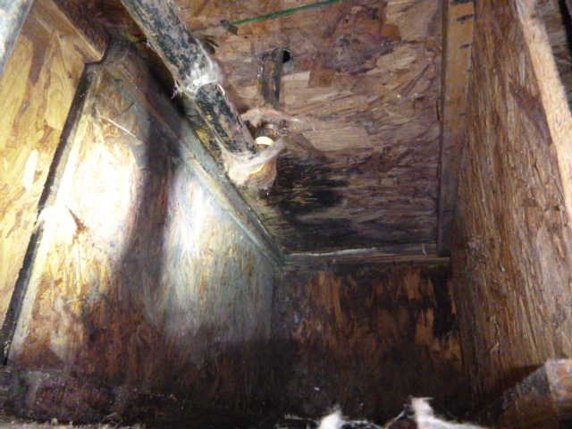

George I have learned that many areas that are of substantial size you can push on and feel the substrate give. The chimney in the pics are a good example. The back side is solid, but where the gutters have been leaking over, the sides were mush.
You should see the look on a buyers face when you walk up to a spot under a gutter and push the wall in about 3 inches.
