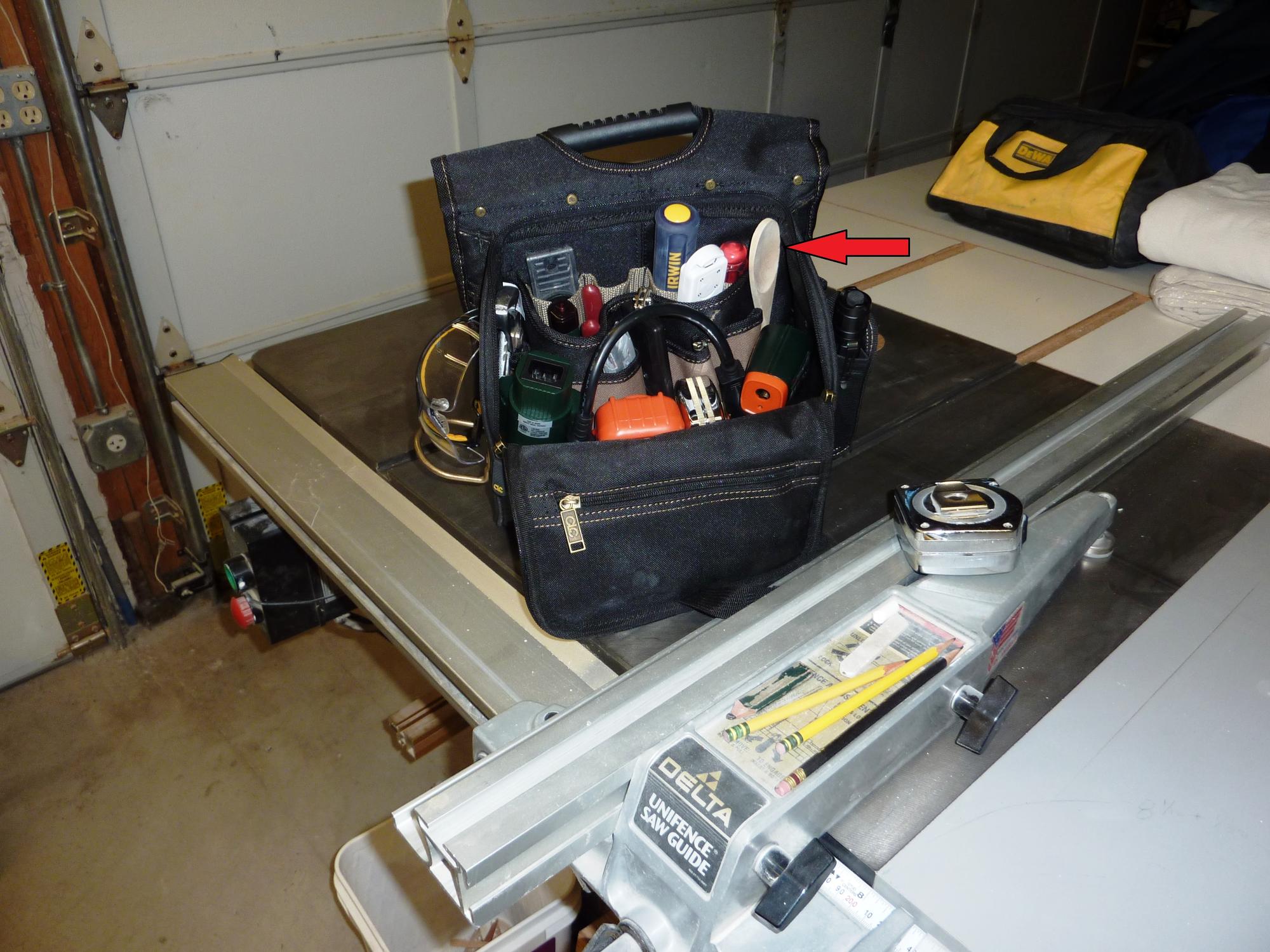

You guys are going to laugh at me.
Although I don’t do it often, once in a while I feel the need to poke around inside a panel to see something obscured, or point something out to a client.
I always immediately put my screwdriver away after removing the dead front, because I am afraid that I’ll forget that I’m holding something conductive.
So, when I put away the screwdriver, I pull out an old wooden spoon and use the handle end to poke around. That spoon in my hand is odd, of course, but serves as a constant reminder that I’m messing with electricity.

**Author:** ![phudak](https://sea2.discourse-cdn.com/internachi/user_avatar/forum.nachi.org/phudak/32/57038_2.png) [@phudak](https://forum.nachi.org/u/phudak)\
**Post date:** [January 26, 2017, 4:31pm UTC](https://forum.nachi.org/t/electrical-inspection-gloves/113280/16 "2017-01-26T16:31:03Z")
</div>
The Spoon 🙂
 ![The Spoon.jpg](https://global.discourse-cdn.com/internachi/original/3X/f/b/fbd48df634a817f2df12741f1f30da27c0f611d1.jpeg)
