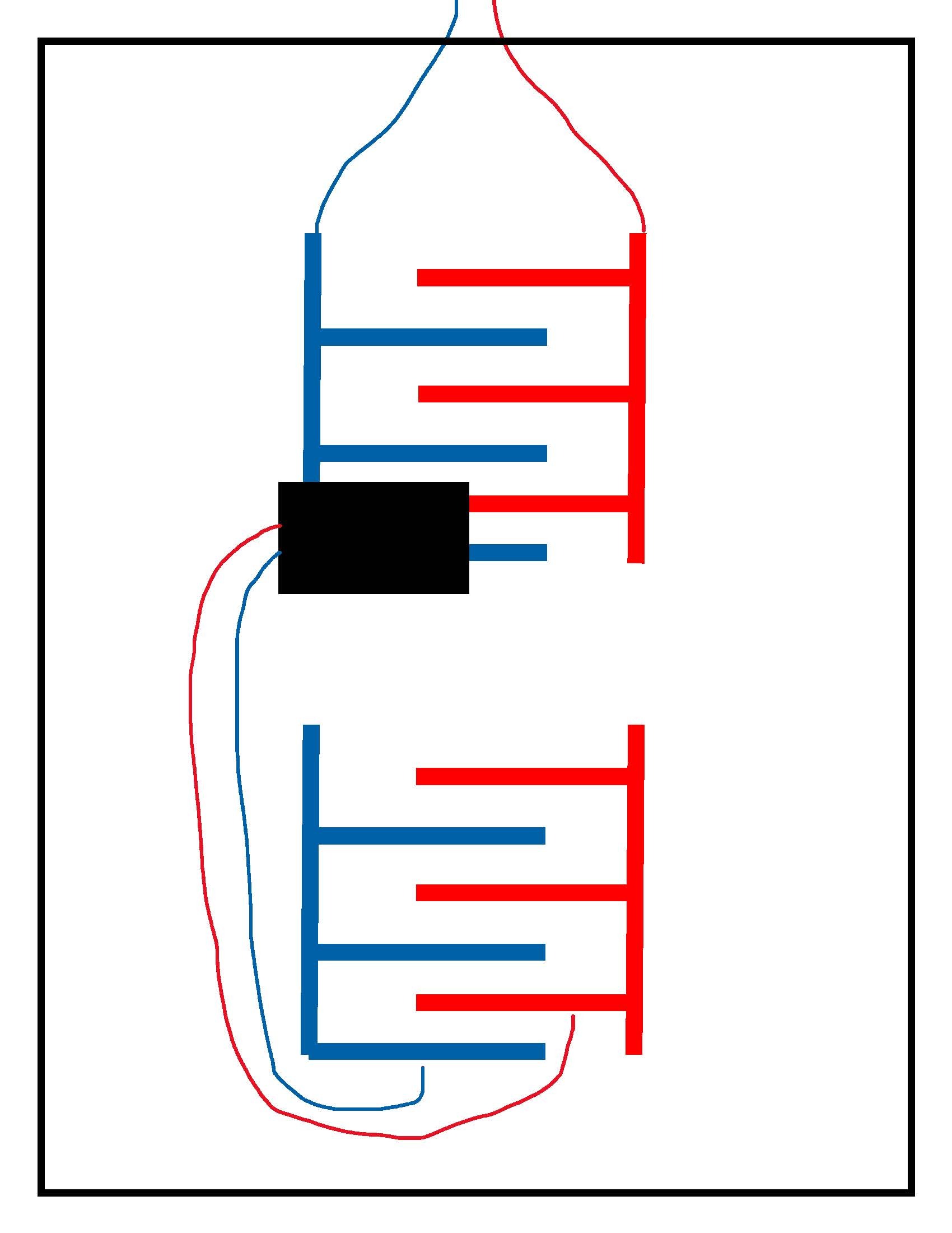

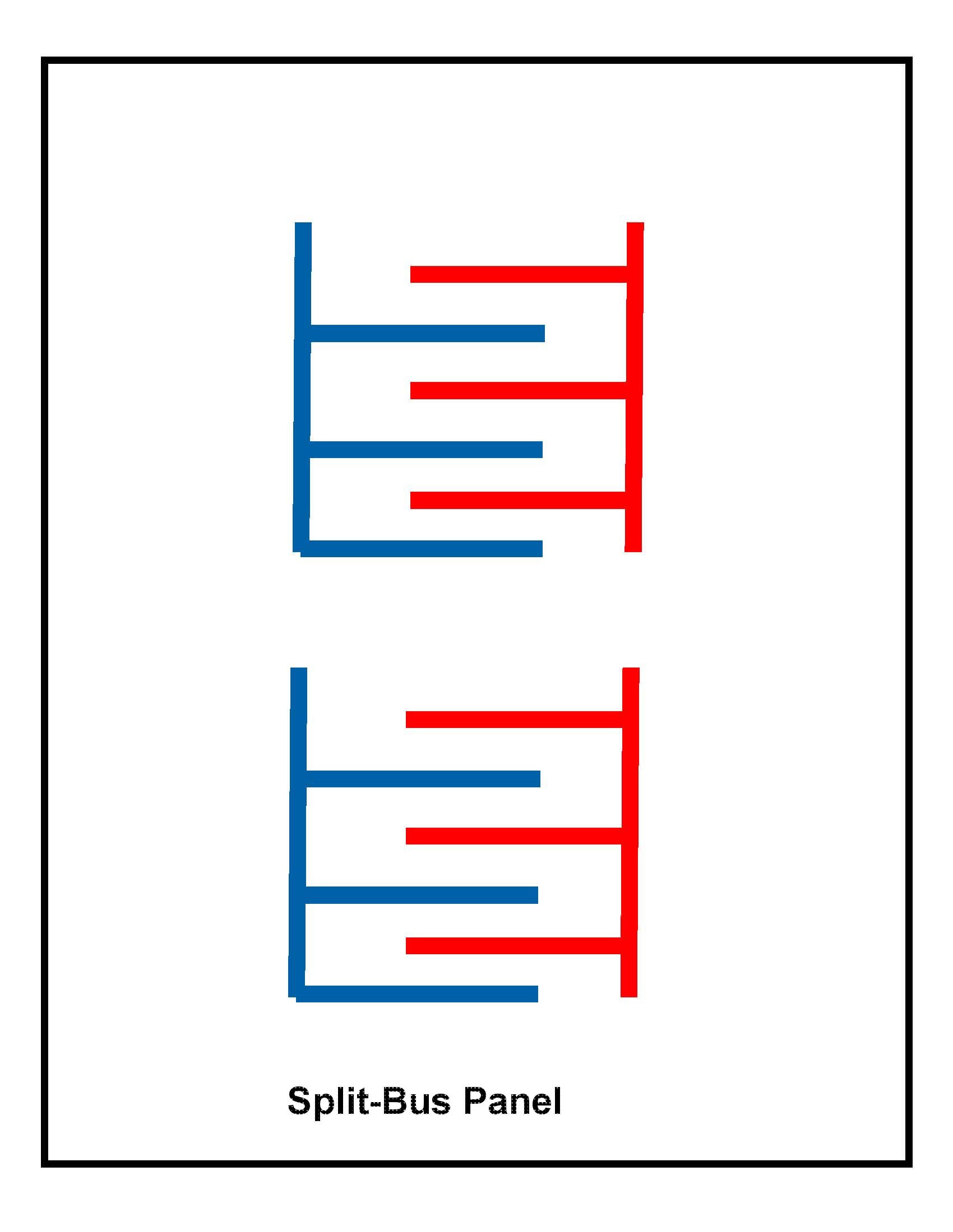

This is a split bus panel where the 50 amp, 2 pole breaker is feeding the lower portion of the panel.

Kaitlan, it is a split bus panel.

The diagram above shows how the breaker (shown as a black rectangle) in the upper part of the panel supplies power to the lower bus in the panel.
This is from MORGAN INSPECTION SERVICES
Thank you. I have never seen this before, I will do my research!
