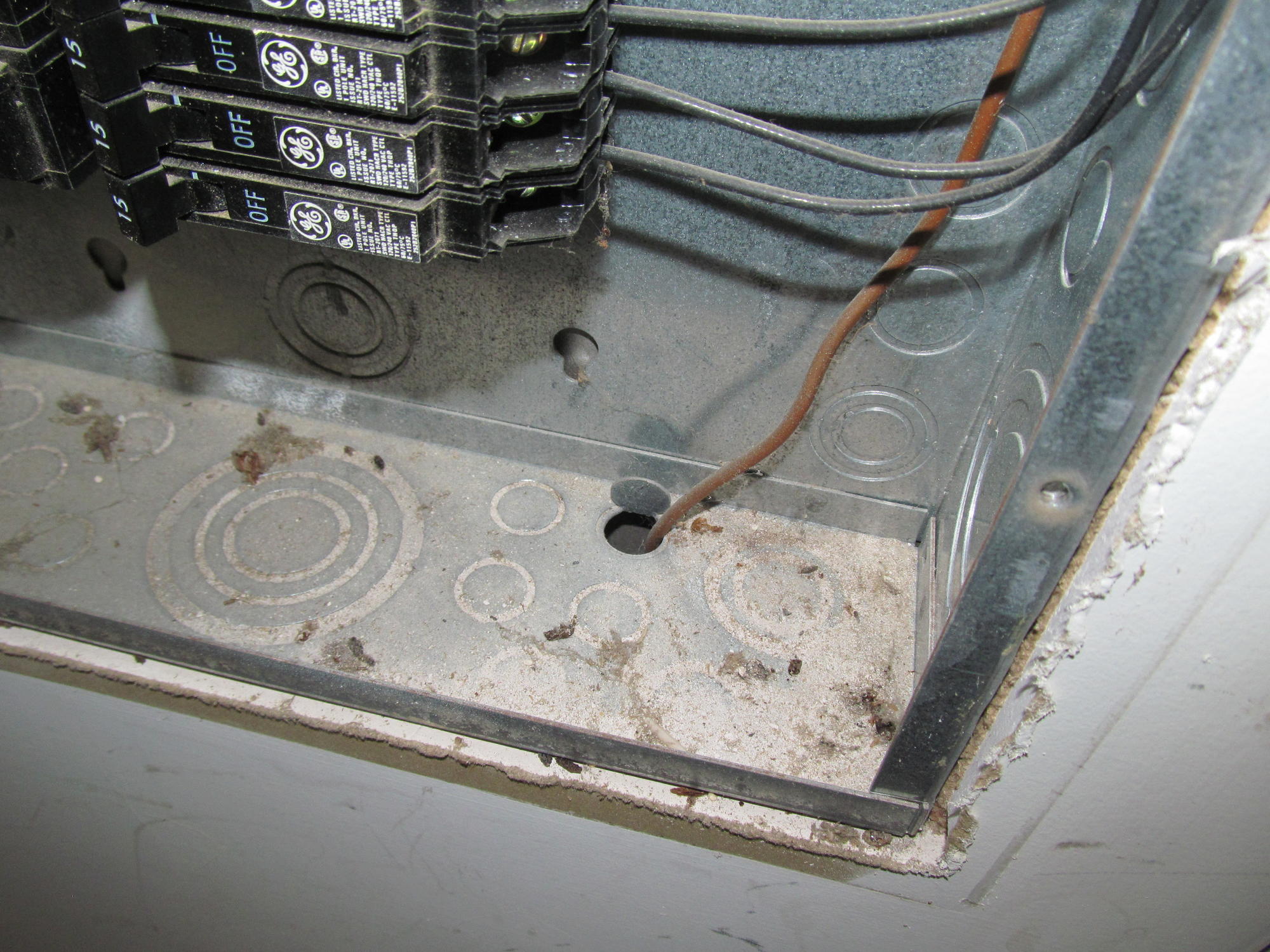

Electrical Panel
Electrical panel is blocked by storage in front and the side does not have 30 inches of clearance to the inner wall.
It is a General Electric Panel.

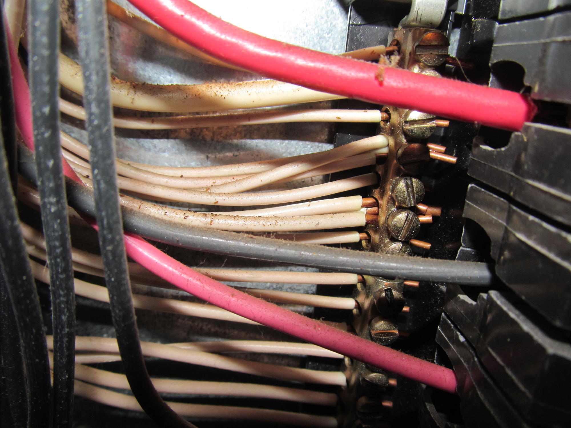

The panel is found to have double tapped wiring on one side and triple on the other.
The panel is not required to have clearance on both sides.
The panel can be anywhere in the 30 inch width.
Many panels allow multiple grounding conductors in one hole. Check the label.
This may help here;
There can be two grounds under one screw, but they must be the same size. There can only be one neurtal under one screw
