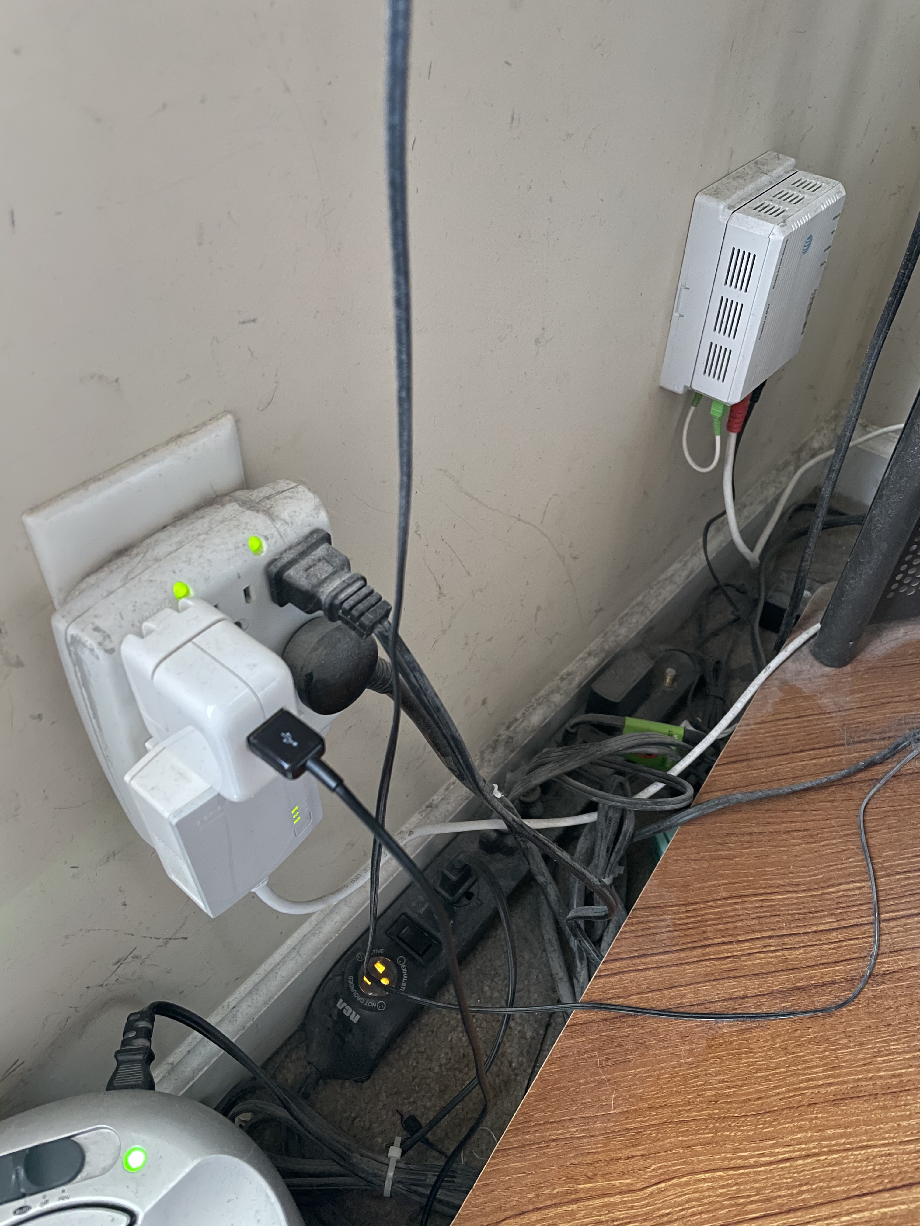

Noticed that this bedroom AFCI breaker was running a little hot. I asked the current homeowner if they have any issues with the bedroom outlets. Stated that it’ll trip when they use the iron. Went to the bedroom and found this gem. Recommended correction :rofl:
Curious, what correction did you recommend?
Basically if possible, to remove some of the devices from this single outlet including the power strip.
A fire waiting to happen… :unamused:
GM Larry. The current homeowner responded with, “I know, I know” as if he knew that he had too much stuff plugged in. When he saw the FLIR image, it put it into a whole new perspective and started unplugging stuff almost immediately.

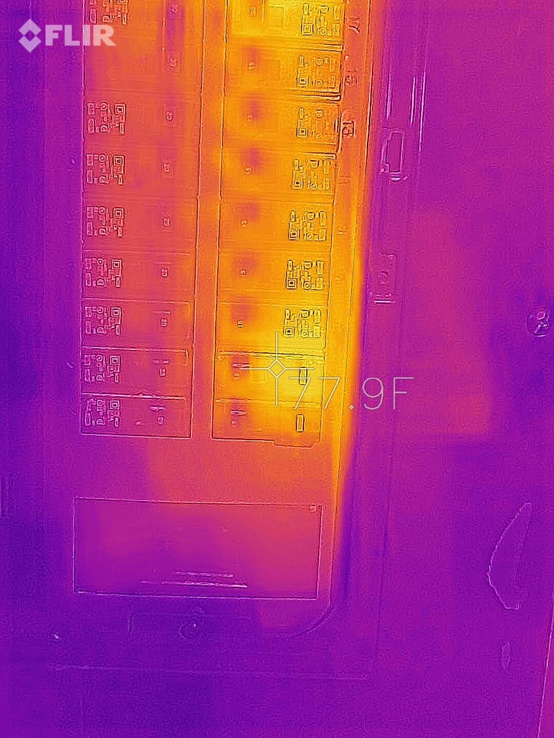

I don’t see anything wrong or too much stuff plugged in. All I see are few watt electronics, few chargers, music player – typical computer room setup. You can safely load a circuit 80% So unless I knew for sure it was more than that I would just explain verbally how things work to the client. Plugging in a clothes iron (1700watt) pushes 15amp circuit to its limit, so that is obvious and expected if you’re going to have all those extra things plugged in. Simply iron in a different room or off of a different circuit.
Remember, AFCI breakers will run warm without any load on the circuit. 80F is not a cause for a concern.

Hey Simon. I agree with all of that, but keep in mind that this was just one outlet in the bedroom. There was another that had a TV, playstation, stereo equipment etc. Additionally, The breaker below this one was also an AFCI in a guest bedroom that was nowhere as “hot” as this one. Either way, I decided to let the homeowner know and let them make the call.
I agree with Simon I would not call that circuit overloaded.
Certainly it would be great if they had additional outlets for all of the electronics that were plugged in, but you might want to know what the normal, above normal and dangerous operating temperatures of different equipment are so that when calling out something as dangerous it really is dangerous. According to Eaton - their breakers operate between 80 -120 degrees. If you have a thermal camera you might want to learn how to use it.

However, the thermal pic does not show a hot breaker/connection.
As I responded to Simon, I agree that the breaker was within temp limits. I get that. I was trying to share a recent experience and not to have all of the electrical engineers pound it home. It was just an observation in which a simple recommendation was offered. I just started in these forums and for the most part it’s all doom and gloom. Too uptight in here for my blood

Arc-Fault Circuit Interrupter circuit breakers normally run warmer than circuit breakers. As well as dimmer switches.
This is normal, there’s nothing to report here.

Victor, if you read what you wrote it sounds as if you thought that the Flir image showed something dangerous which is false. If you post here expect feedback, we don’t always agree but this forum is a great source of information.

As for AFCI breakers, they run warm.
Most feedback you are getting and will get has to do with that thermal image.
  1. AFCI’s do run warmer than standard breakers (so do GFCI’s)
  2. 80 degree F is not high for a molded case circuit breaker (10 degree F rise over 70 degree F ambient) If you check amperage you will understand much more about that circuit.
Victor, there may be an overload condition that trips a breaker. In that case, look into it and advise as necessary. However, the thermal image does not in any way support the claim that the circuit is overloaded. Not the picture in your post anyway. If you want to use thermal imaging in your business, at the very least do the InterNACHI course. If you already have done so, great! Then I would encourage you to do further education through Infraspection, ITC, Snell, or Monroe Infrared. People on here mention expert witnesses and such. This is more to warn you of the potential liability if you further use IR without proper training, especially with electrical. If you scan electrical, especially quantitatively, you should get a level 2 certification.
