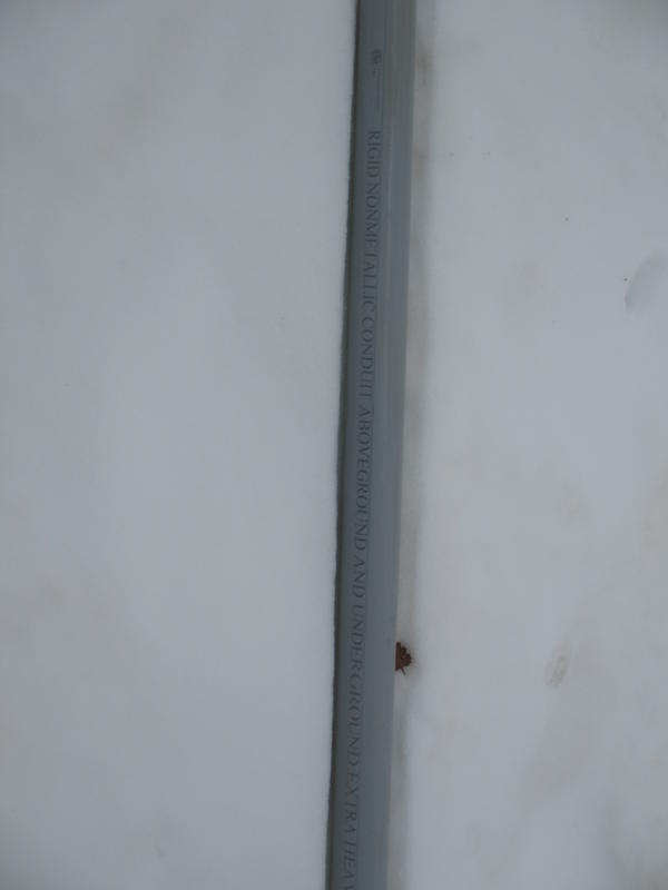

I see overhead and underground every day but this was first.

I’m curious how sod you write this one up and what the realtor said about showing a house with this?
I reported that the electrical service needs to be installed a minimum of of 18" deep when routed across a homes property.
Call a licensed and insured contractor for further evaluation and repair or replace as warranted.
The client was wondering if she should just pay to have it done. I informed her to call the electrical inspector and see if a permit was issued for this, and that the home owner should be the person to repair this mess.
is it temporary because of the frozen ground?

I wondered the same thing, because the conduit is on top of the snow. Maybe a temporary fix until spring, when it can be buried ??
I did get a response and the service line is temp. The service I was told just quit working one day a couple weeks ago, so they ran this. Funny though the buyer thought it was suppose to be there, and when she contacted the seller we found out what happened.
But the seller thought the buyer should take care of it after closing. My suggestion was to have the the seller fix it since around here to run under ground is quite expensive.
