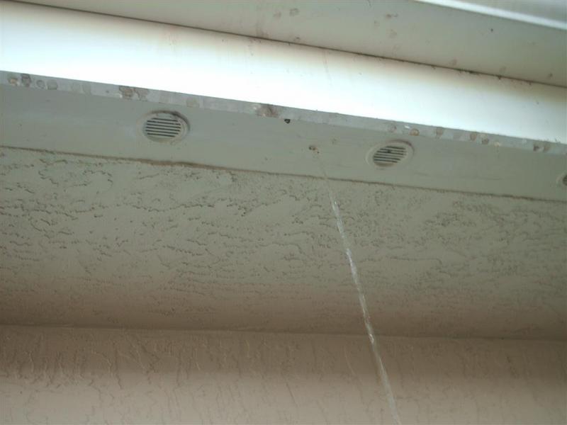

Here is a little a/c work.
And, as the Realtor said, “A roof leak…where?”
