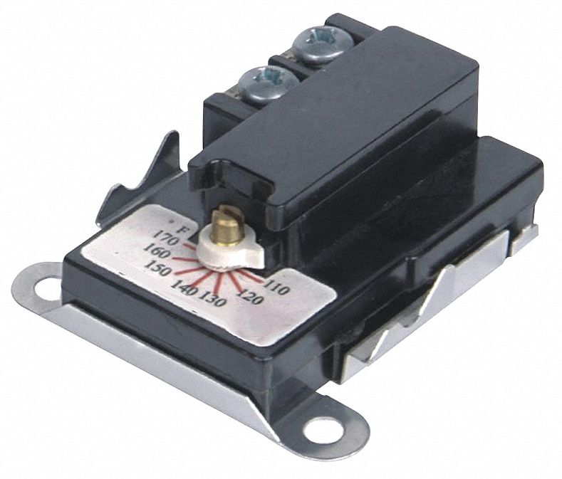

The T-stat on a residential electric water heater are #1) sealed contacts and #2) more than 18" above the bottom of the water heater on some models, so there is no reason to elevate the tank.
Let the Code Officer know how stupid his determination is.
[http://imageserver.grainger.com/is/image/Grainger/6XZV1_AS01?productdetail](javascript: void(0))
Sorry Marcel but just look at the photo you posted. Those contact screws are in the wide open, not sealed. The same goes with the contact screws on the end of the heating elements. They are not sealed either. The thermostat is normally located at the top element with the reset button, so it is not an issue. The bottom heating element is less than 18 inches from the bottom of the tank, therefore the connection is also less than 18 inches. A loose wire can mean arcing. Don’t ask me why it would arbitrarily come loose without movement of some sort but there are times when people just replace the $20 element instead of spending $500-800 for a complete new heater.
The screws you are looking at is for the Line Voltage, and the contactor is in a sealed case.
