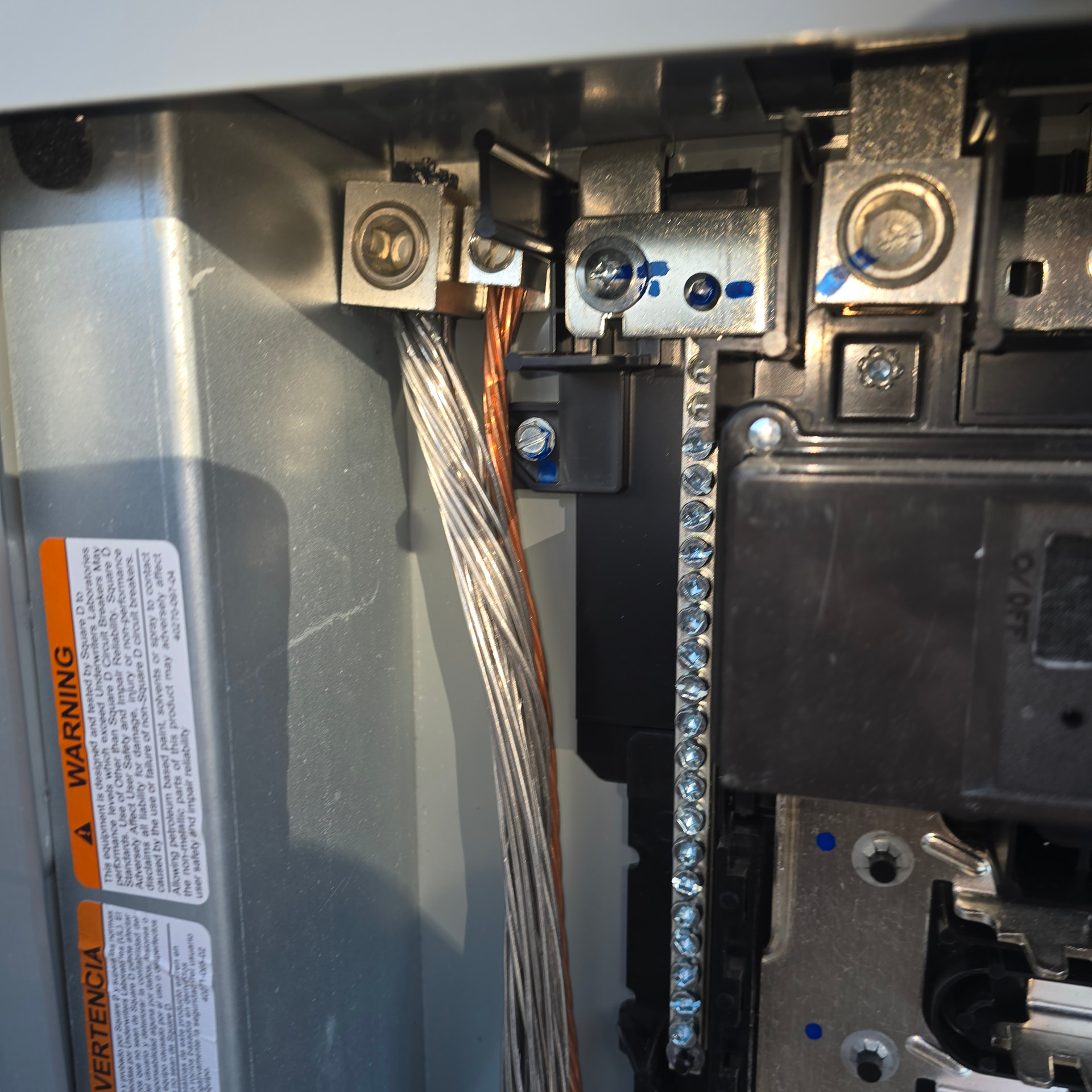

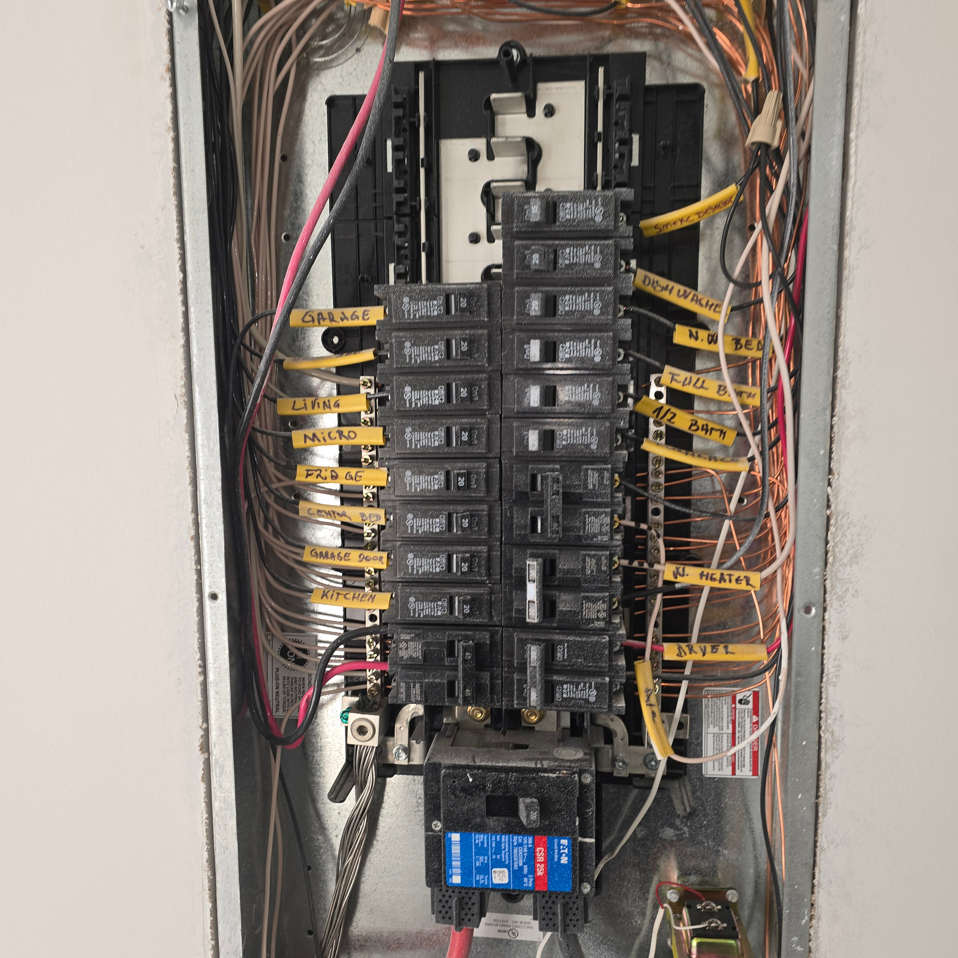

I’ve tried reading up on this via past post and I’m still a little confused. If somebody could help me out with this setup I’d greatly appreciate it. Just wondering if the interior panel which is directly on the back side of the emergency disconnect is considered a sub panel? TIA. Following pics are of the outside emergency/service disconnect. It was labeled emergency on the outside and service disconnect on the inside.
So, from what I see in the pictures, the single breaker is the Service Equipment or main. Everything else downstream would be a sub-panel. The picture of the panel inside shows a sub-panel with a main breaker that turns off power to the panel. This panel should be treated as a sub-panel.
On a side note: In that sub-panel at the lower right corner is a low-voltage transformer, most likely for a doorbell. Those are not allowed in the panel, and it is most likely causing a “double-tap” in order to power it.
The interior garage panel was a three wire feed with the ground and neutrals connected together.

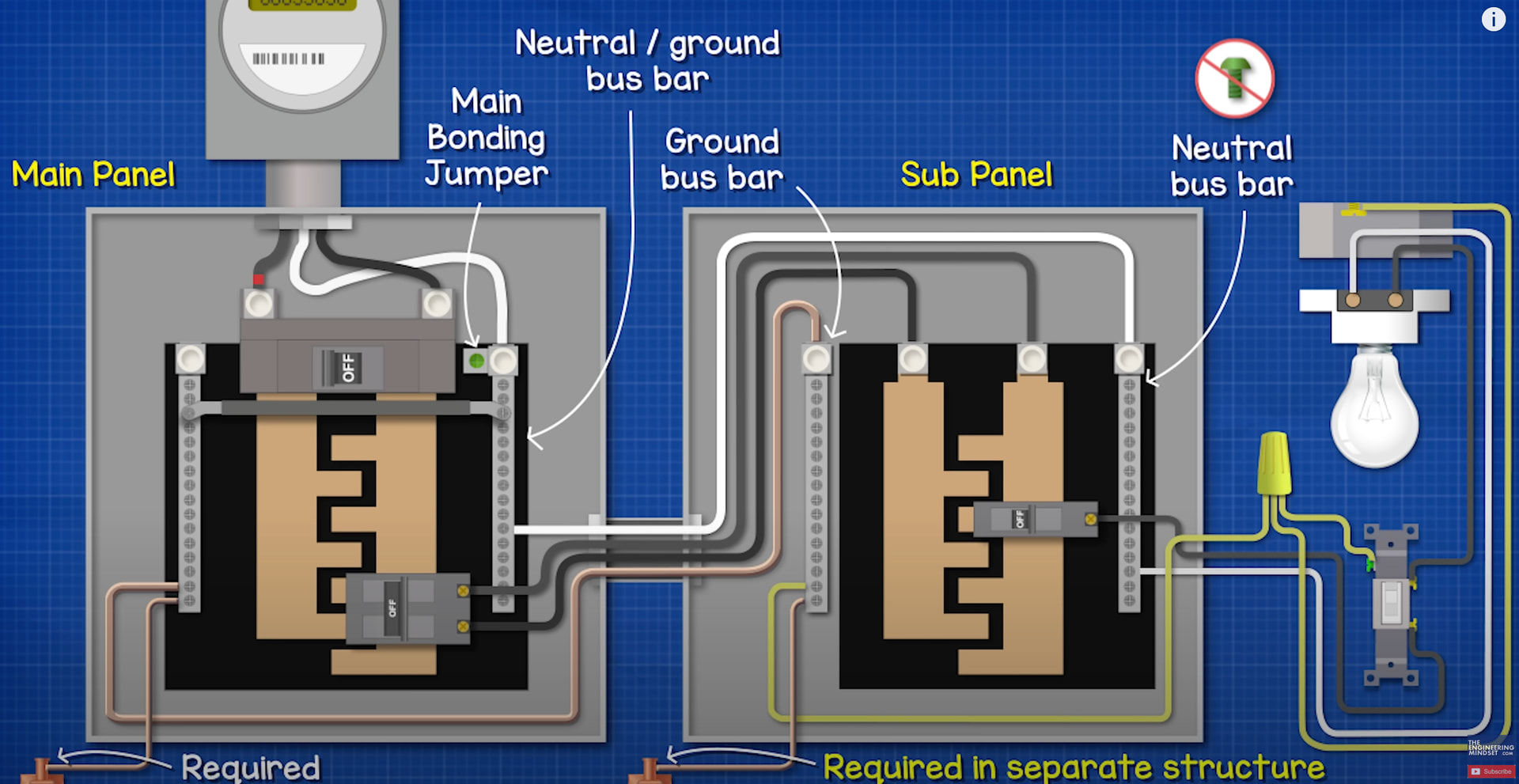

Maybe this helps explain what you were looking at.
I just did a bout 30-40 units in a 2025 town house build and removed the interior panel cover in the garage. Eaton panel with a neutral bus just like yours. The interior panel is the service panel and the ground and neutral are bonded there (green screw - bottom left). It is a three wire feed from the Emergency disconnect. While the Emergency disconnect enclosure is grounded, the neutral is not bonded to ground there. It is bonded in the service panel in the garage.
Do you have a wider picture of the outside panel? It looks like there is a GEC connected to the neutral there from your top picture, and it’s not quite possible for my eyes to see a GEC at the inside panel.
The ground and neutral were connected/”bonded” to the exterior panel enclosure via lugged connections. SEE PHOTO.
Makes no difference the interior is the SERVICE panel. There is a 3 wire feed and the neutral and ground are bonded at the SERVICE panel. What’s done at the Emergency disconnect is of no concern to you. You need to understand the reasoning for the single bond and why objectionable current is not a concern here.
His top picture looks like it’s from the upper corner of the outside panel, but nothing showing the full panel or a review of what conductors are running in and out of it. That’s why I asked if he had any other photos of it.

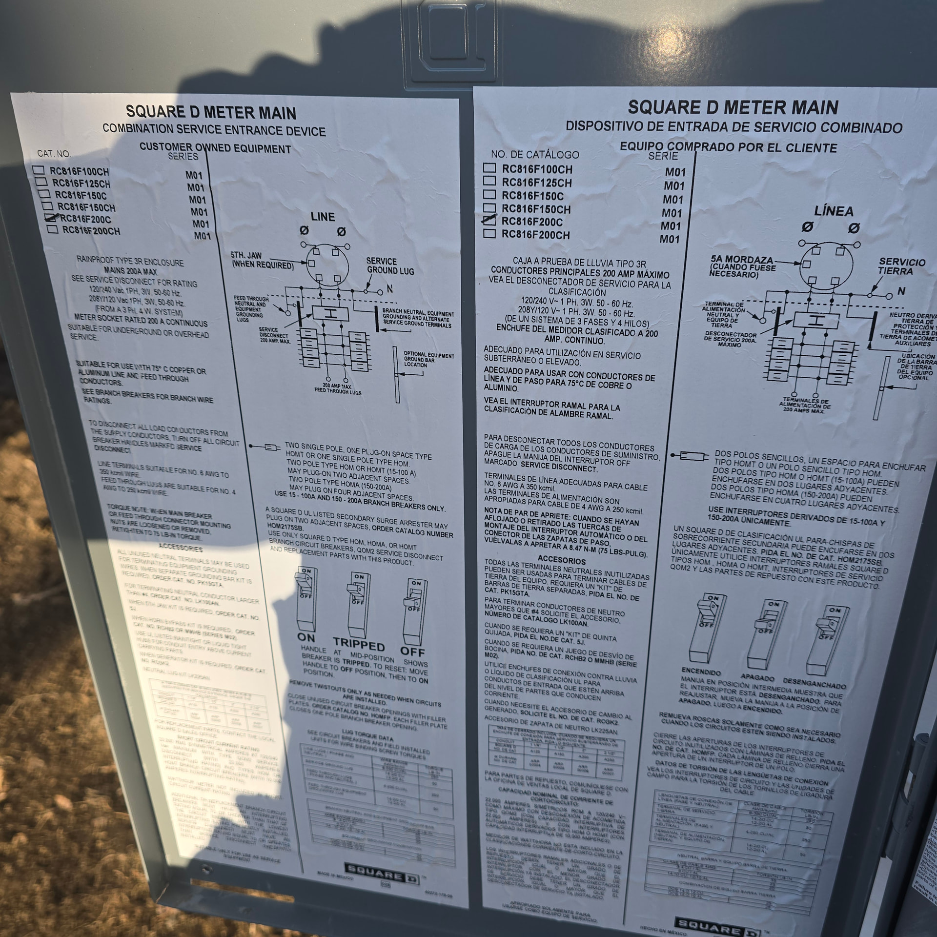

The 3-wire SE cable to the interior panel is a violation. Since the exterior panel has a single disconnect and spaces for other branch circuits that must be wired as the Emergency Disconnect/Service Disconnect. The panel on the inside is wired as a sub-panel with a 4-wire feeder.
So, if the outside panel did not have these spaces, then it would be fine to have the 3-wire service feed to the interior panel?
Like this panel?
That’s the way it sounds. I was not aware of that little caveat in the rules. Hopefully Robert chimes in to confirm if that is the distinguisher.
