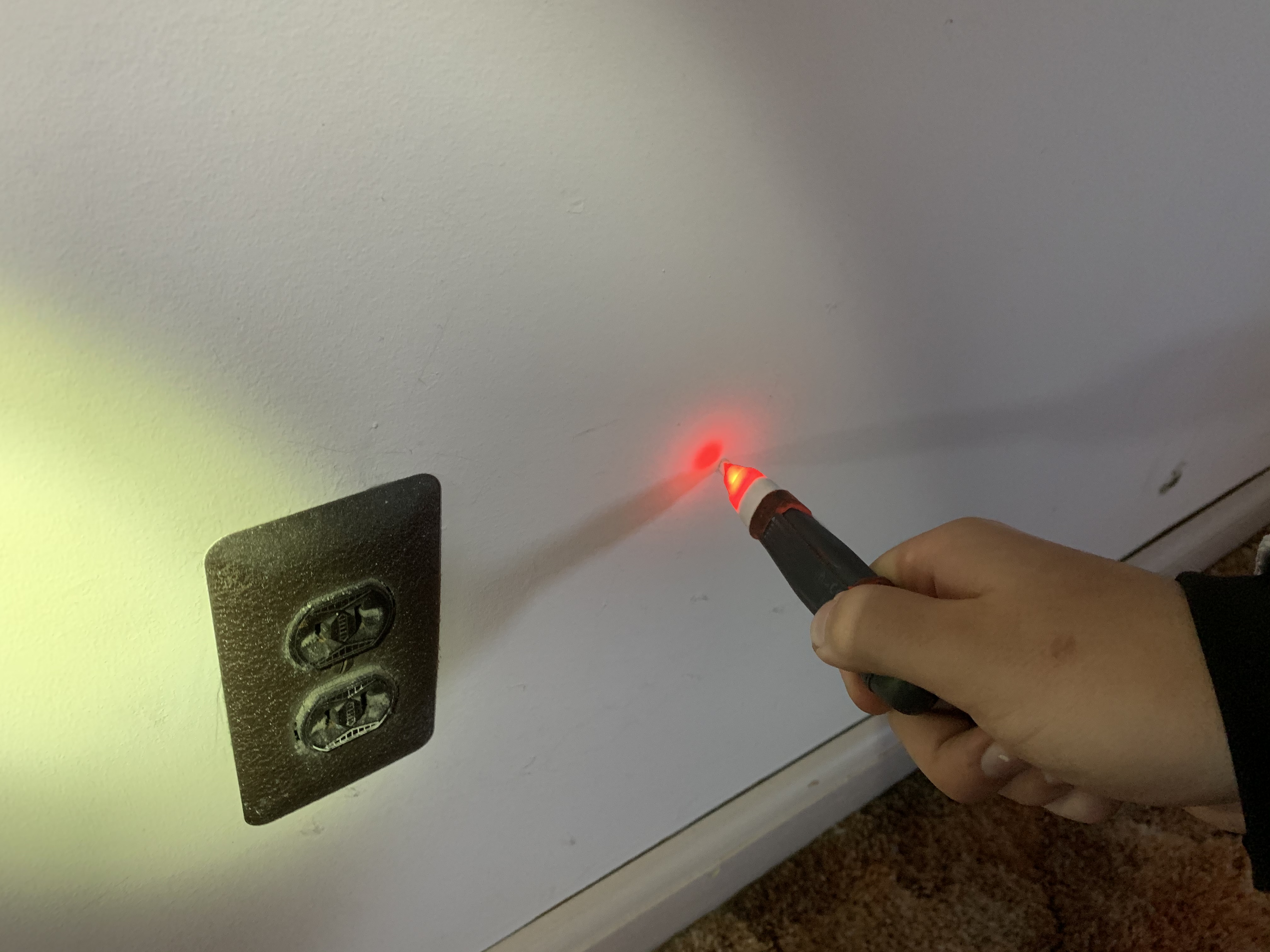

While doing an inspection yesterday as I always do with two pronged receptacles tested for power with a touch voltage tester. Before I was even close to contact the tester lit up. I started experimenting and checked the drywall around the receptacle and the drywall appeared to be energized all the way around the receptacle about 6 inches. I alway have a spare tester with me and double checked with the backup and the same result. I checked every receptacle and switch in the room with the same result. I checked every receptacle and light switch in the rest of the home and it was only the one room. The buyers brother who was a licensed electrician was present and had no idea what the cause would be. Just looking to se if anyone else has ever seen this or knows what would cause it. I always like to know when possible.

Pretty surprising, as induced voltage and other “false positives” with a non-conductive tester are a common and well known condition.
Typically this occurs when the outlet is un-grounded (we already knew that) AND it is in a metal outlet box (also un-grounded). The outlet box changes (enhances) the capacitive coupling of the “sniffer.”

What years the build.
What type of wiring? K&T?
No ground on outlet.
Look were you have your tester, voltage sniffer. K&T run 90 degree cables on framing memebers.
You are sniffing 90 degrees of the terminals.
outlet
Wiring is close to the drywall / Plaster Lathe with K&T at times.
Buy a better voltage sniffer. Fluke 1LAC II A Non-Contact Voltage Tester. At the very least know the range you are sniffing.
