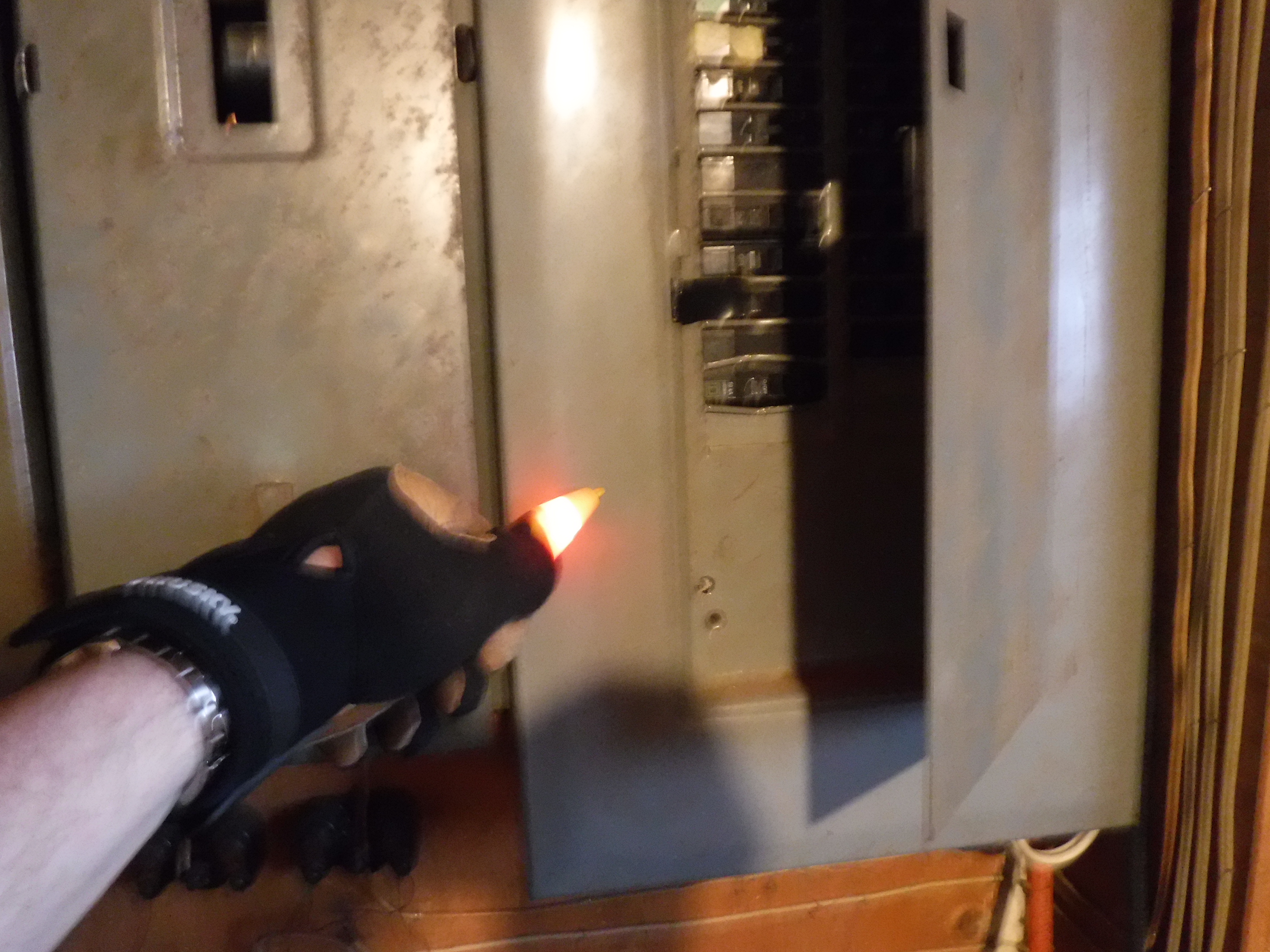

Hey everyone, hope your all doing ok.
I came across something that I found puzzling and I’m still learning so looking for some clarity.
I inspected a single family house built late 50’s / early 60’s and one of the first things I do when I get to the main service panel is do a quick test with my non contact tester just to make sure that the whole panel is not energized. This one happens to show that it is as the light went on and the beeping sound went off. So I decided to note this and not inspect further.
However, the agent (pre-listing inspection - seller agent) touched the door and the panel (for whatever reason) and nothing happened. He was not wearing gloves or anything.
Was my tester incorrect or is there something I’m missing as I don’t understand. Here are some photos.
Appreciate any feedback. Looking to learn.

I’m sure so better experts will chime in shortly. The non contact testers show the possibility of a voltage based on the emf of house wiring. So sometimes they give erroneous readings. That said if it goes off, stop, and kick it to an electrician to diagnose. To get a shock from an energized cabinet you need to be grounded. In the right circumstances a person might touch a cabinet with stray voltage on it with one hand and rubber soled shoes and not feel anything.

False readings with non-contact voltage “detectors” are common.
Search the web for the facts and science. Stray voltage, induced voltage, and non-grounded circuits can cause that condition, amongst many others.
I’ve owned some that trigger an alarm from across the room, and others that won’t trigger while touching a live conductor.
You need a reliable electrical tester or a wiggy.

You need to Google Capacitive voltage tester. [Understanding Capacitive Coupling](https://www.ecmweb.com/content/what-do-you-know-about-capacitive-voltage-sensors)
In the future the test you want for live dead fronts is to lightly touch it with the BACK of your hand… The voltage sniffer test is unreliable for panel covers.
Milwaukee makes a good non contact tester.

Max, hopefully by now you read the link I posted to Capacitive coupling in the 5th post of this thread. If you did I trust you paid particular note to the part that described coupling to grounded and ungrounded boxes. In your case I would suspect, since the sniffer went off but the Agent was not fried. that the panel had poor to no grounding. An earlier thread on this subject dealt with ungrounded metal work boxes around outlets and the fact that sniffers would light before the tester touched the outlet.
