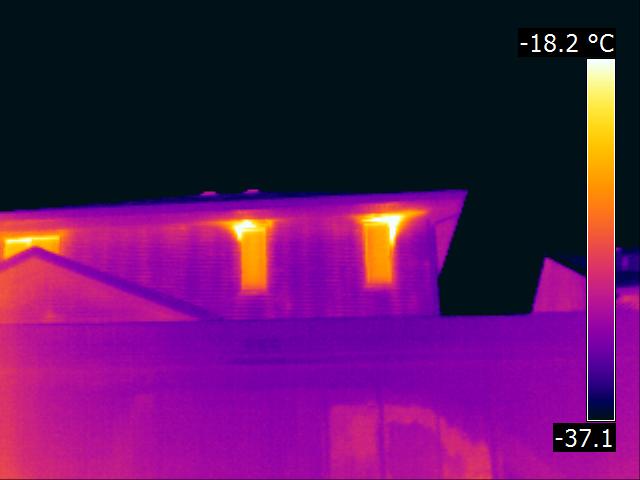

Here are a few images of heat loss (exfiltration) at exterior envelope.
Kevin

I realize that you have been doing this longer than myself, but I took some pictures that are similar and was wondering if there is a reflection from the window?

If you are referring to the tree branches in the windows, yes ![]()
Kevin
No I am refering to the lighter area above the windows.
Lawrence
You mean the hot air exfiltration leaking from the top of the windows. That’s no reflection, trust me. It’s hot air leaking from the windows
These are older double hung windows. Most of the window locks at the meeting rails were worn or loose causing the upper sash to drop. I confirmed the gaps at the top of each of these windows. Very leaky!!

Here they are let me know what you think.
Thanks
Lawrence
Awesome! I really like the second one. Good example of air exfiltration.
What camera do you have?

What time of the day or night are taking these readings.
Scans come out nice when you have a good Delta T. (70 degrees?)
It’s below zero F there. The hot spots are -.76F
Night time…few hours after sunset.
Kevin
For an effective exterior building envelope scan you have to have a minimum of 18 deg F temperature differential. Not only for the time of scan, but for several hours before the scan.
I’m not sure how Lawrence tuned his camera, but my Delta-T was around 35 deg F.

Mine were taken about 5 hours after sunset with a outside temp of -25C. (sorry for the metric). These pics were taken with a FLIR EX320 with a wide angle lens.
The delta T that you are talking about is that outside temp from mid day to night or are you talking from inside to outside?

I would not say that you “have to have” but the more the better!
Down here in the South it can be very difficult to get temperature differential.
This does not mean the camera will not work for you.
The quality of the scan will substantially degrade and air movement, sunlight, HVAC etc. will substantially affect the capacity to detect thermal anomalies. The camera is capable of temperature differentials below 1°C. That’s all you need to get an anomaly to show up.
I would highly recommend that the 18°F temperature differential not be disregarded if it can be achieved.
I also recommend that your report documents if testing was conducted outside of the 18°F temperature differential recommendation. As this is an industry standard, any deviation from it warrants explanation.
Inside/outside.
