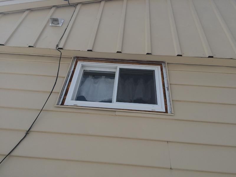

This is a photo I took of a window with no trim or exterior covering. Although caulked and sealed on the interior this penetration on the exterior allows unconditioned air to enter the interstitial space of the wall.

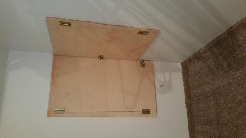

Here are two attic access hatches that were recently weatherized with weather stripping and insulation. Adding proper access panels like this has helped reduce the overall air movement through this building.

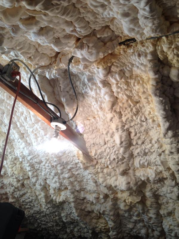

Here is a picture of spray insulation installed in an attic space. What I liked about this was that the installer did not just spray the foam between the rafters, but sprayed enough to also encapsulate them.
