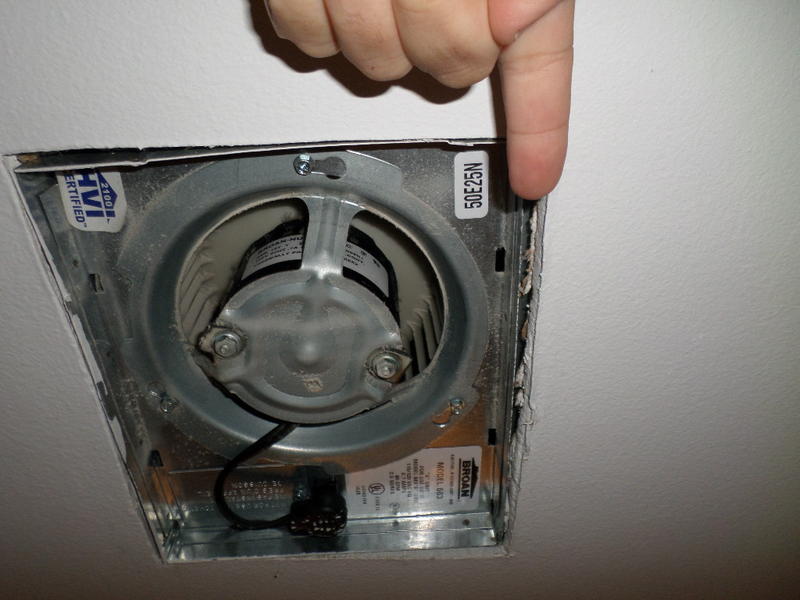

After removing the cover of this bathroom exhaust fan to look for air leakage, I discovered that the gap had not been caulked between the exhaust fan frame and the drywall. This is an open hole in the air barrier carrying warm air and moisture directly into the attic space.

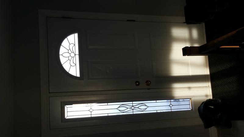

My picture is of the front door with a side window in for letting light inside.While using a a smoke pencil around the vertical widow to the left of the door, it was revealed a significant air infiltration around it. I suggest removing the frame around the window and fill the voids with foam spray insulation.

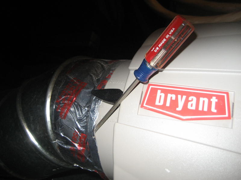

heat duct taped but tape is stiff and can be moved around.air movement detected as heat loss into room

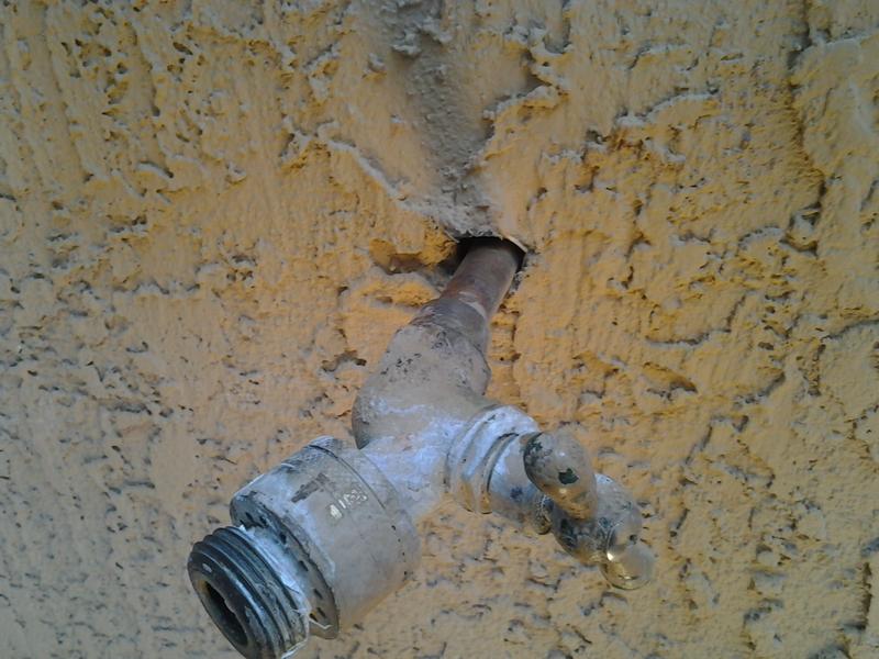

Here we have an air gap around water spigot. Recommended caulking and sealing as needed.

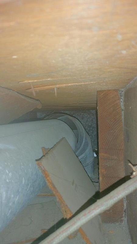

This is a photo of a detached supply duct above the furnace plenum. This is allowing huge energy loss into the unconditioned basement.

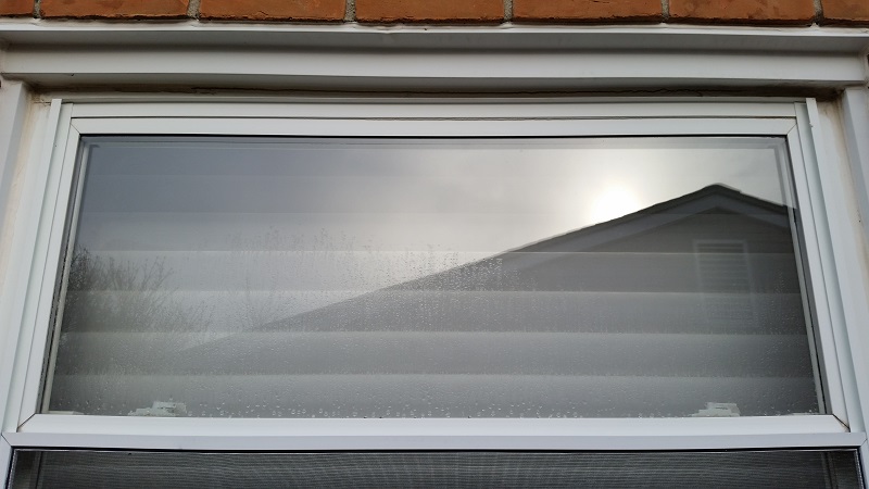

Currently taking the Energy Movement course and just posting a picture here of a window with deteriorated and failing seals. Obvious moisture intrusion is noted in the top window panel as condensation can be seen.

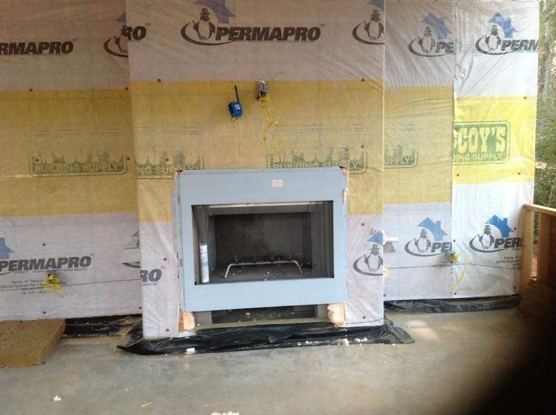

Tyvek
Builders install this Tyvek so that when moisture penetrates. it will meet the Tyvek and drain away before the sheathing absorbs it, where it can cause decay. Tyvek also prevents air infiltration.
