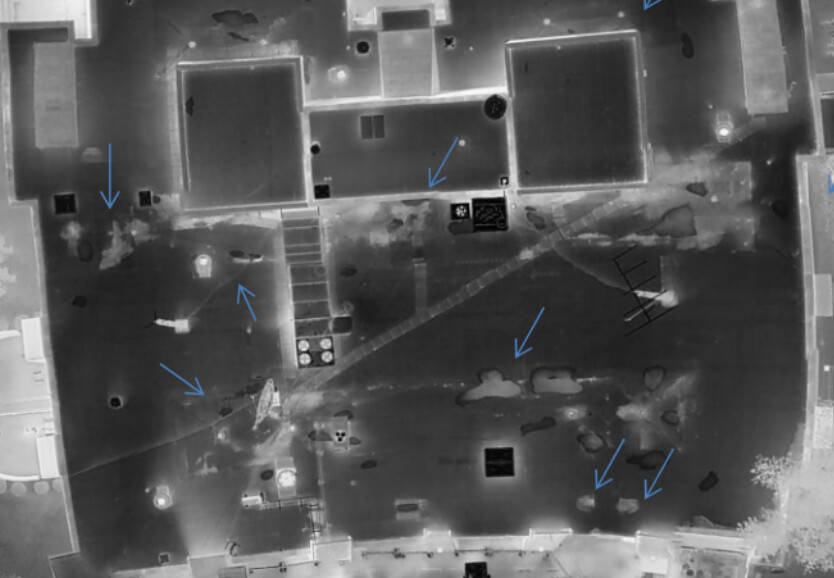

I’ve been looking at EPDM roofs for 26 years, and the OP’s photo looks pretty much exactly like the Firestone flashing illustration. In both the rake (lower edge in the photo) and gutter (to the right in the photo) locations. Water flows to the right in the photo you posted.
That perimeter strip is the standard 5 inch adhesive seam strip that all of the EPDM manufacturers sell. That doesn’t look to me like an old membrane. Looks to me like the typical top seam strip you see along edges with flashing. I think maybe the black edge caulking is throwing you off. In other words, the main field of roof membrane isn’t cut short and laying over an older membrane at the edges.

As well, to me it appears the tentest organic mulch board insulation or other organic mulch board under the membrane is swollen. It has been saturated. The section to the left is bumpy. You can see a tentest mulch-board insulation seam line. The right side is smooth. It certainly is not smooth from my visual perspective on the left side.
Non-destructive testing using thermography or a non-penetrating moisture meter may be able to confirm that condition on the smooth side to the left of the yellow arrows. I am pretty sure a level 2 or 3 thermographer would spot gravel as well. Just by walking on the smooth surface you would feel the difference under foot. Your weight would notice a spongy feel as you walked.

Thanks for the thermogram in gray scale.
David, would you ever use reversed gray scale palette to hide glare or reflectance from galvanized steel?
No, a palette can not hide a reflection.
This is a stitched composite of over a hundred scans. It is no longer radiometric.
