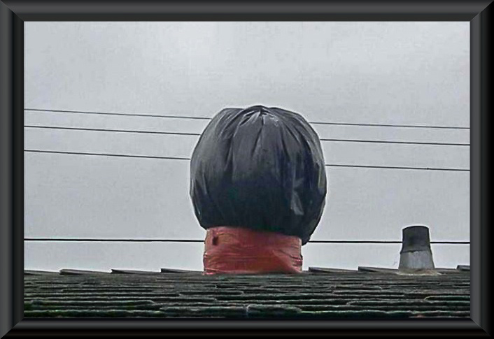

I completely agree with david, but my question is,Why would they do that to the vents!!! looks like they got some bad advise from the bro in law who helped roof three roofs back in college!!!

I used to cover my roof turbines in the winter here many years ago, it gets cold in January, sometimes into the thirties at night…what little heat is saved from the daylight hours will keep your home warm at night in the desert.
You just need to remove the plastic in February, since it was about 85 today…:smiley:

You would probably need to speak with a Hillbilly for corroborating evidence covering roof vents in the winter keeps a home in the Desert warm at night from the sun which shines everyday here…:smiley:
When I was young and had my first home here, I covered the turbines with plastic trash bags in December and January because most homes have very poor insulation here, the older ones, not being able to afford more insulation twenty five years ago it worked very well.
Make-shift enterprising you could call it. Removing the trash bags in February would be necessary, because the sun begins to regain its intensity, thus, starting to cook the attic and roof covering for the next year, which would lead to very premature deterioration of the shingles.

Several years ago the property I was inspecting had a badly deteriorated roof. I stated that it was at the end of its useful life. The seller and her Realtor got me on a conference call and really laid into me. They had proof that the roof was only two years old, that proof being receipts for the new roof that was installed two years earlier.
Turns out that the roof installers put in a few new turbine vents to help with ventilation. Turns out that the owners’ neighbors came over and convinced them to put huge plastic trash bags on all the turbine vents to keep the cold air out of the attic. Cold air in San Diego doesn’t last long, so all the heat that we have literally burned the roof up.
Turns out that the roofing contractor would not honor the warranty, and neither would the manufacturer. The Seller wasn’t willing to put another new roof on, so my Client pulled out of the purchase.
