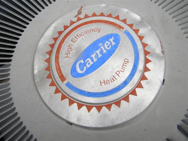

Split system Tag states heat pump but unit has no compressor or reversing valve at the exterior unit

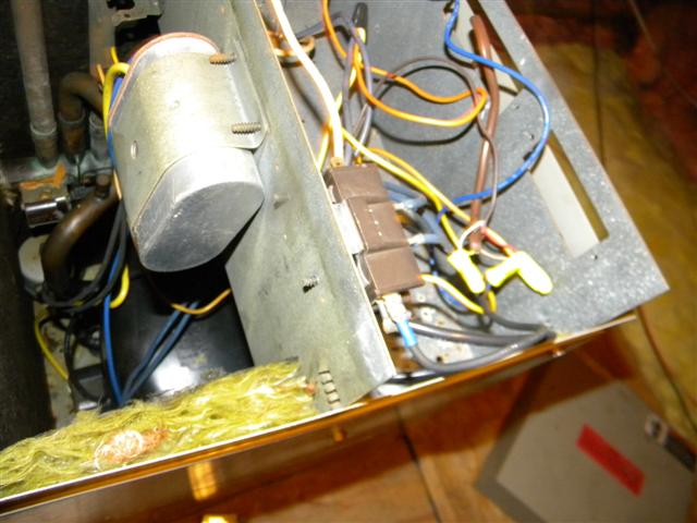

Maybe this will help note the two lines 7/8 copper into the box this is not a ground source heat pump no water

No closed loop no outside pump strictly air to air. The system has a conventional thermostat and when placed in the cooling mode the unit produces cold air at the registers. The kicker is if you touch the large line at the exterior unit it will burn your hand. The key word is in the cooling mode
Ok i’ll try again it it a split system duel fuel ductless heat pump?
This is a crazy system been in this business for over 40 years and never observed a system set up in this manner.
The compressor is within the box in the attic hot gas line travels to outside condensing unit liquid line from exterior unit back to the attic A-coil.
This system originally had a electric furnace but has been converted to Natural gas. The reversing valve located in the box with the compressor is no longer in use thus the conventional thermostat.
This system operates as any split system does except the compressor is remote from the outside unit. Very miss leading just reading the label on the unit because it in essence it is no longer a heat pump

Its a carrier 38 series air to air heat pump and should be coupled with either an air handlier with electric heat or a gas furnace. The outdoor unit is just a condensing coil, the compressor, reversing valve, etc are located in the heat pump section (the enclosed box in your 2nd pic). Were very big sellers in their day but prone to service issues due to age.
It was originally a heat pump but when they installed the gas furnace they disabled the reversing valve except for cooling

No excessive noise noted, the compressor is within the small box shown in the second post I would think excessive heat in the attic would or could be a problem but the compressor has been there since 1986 and still operating.

If it’s like one I worked on one time just like it that had been converted from the old “indoor compressor” type heat pump;
The compressor is cooled the same as all split system units which is by the cool refrigerant gas returning via one of the 7/8" o.d. lines which is the suction line coming from the evaporator.
That is correct on this one the suction line never leaves the attic the 7/8 line at the exterior unit is the hot gas line
