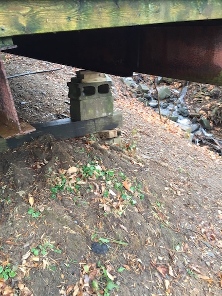

In this photo, I conducted a Home Inspection that revealed a defect with this deck. In the photo you can see the amount of makeshift materials used to try and level the deck. There is a nearby river and where the deck is located, the earth has been eroding, creating a situation that could eventually lead to this large deck falling. The attempt to level is very unsafe and I recommended to the buyer to have a specialist come in and evaluate.
