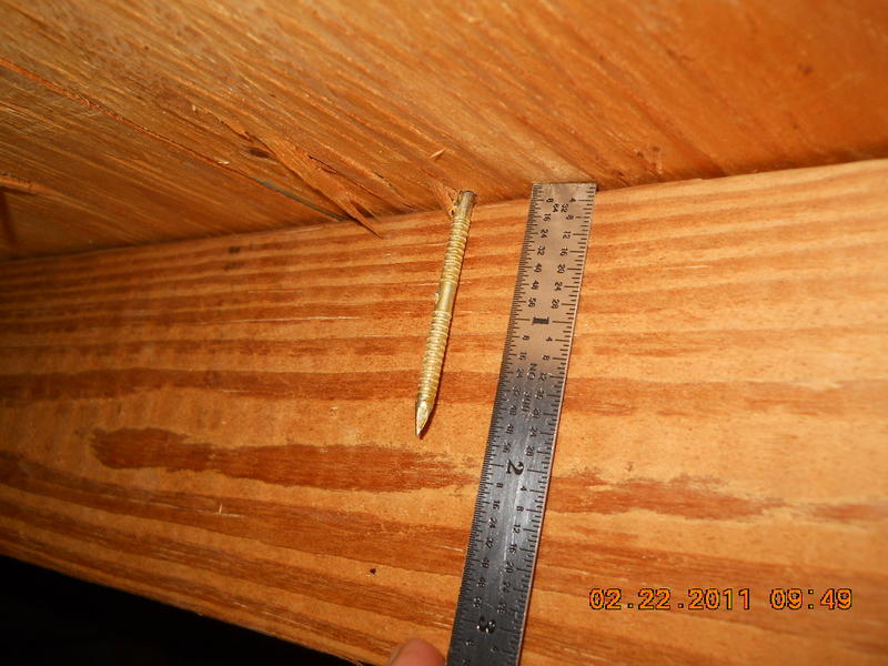

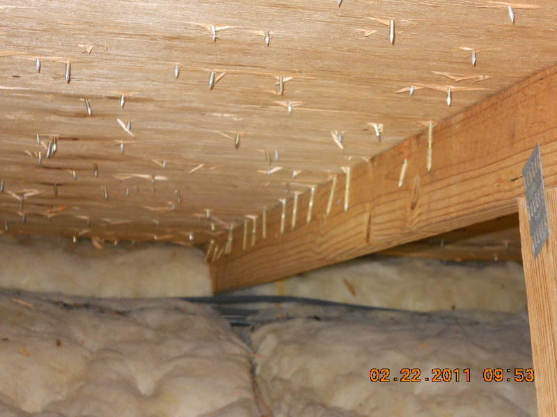

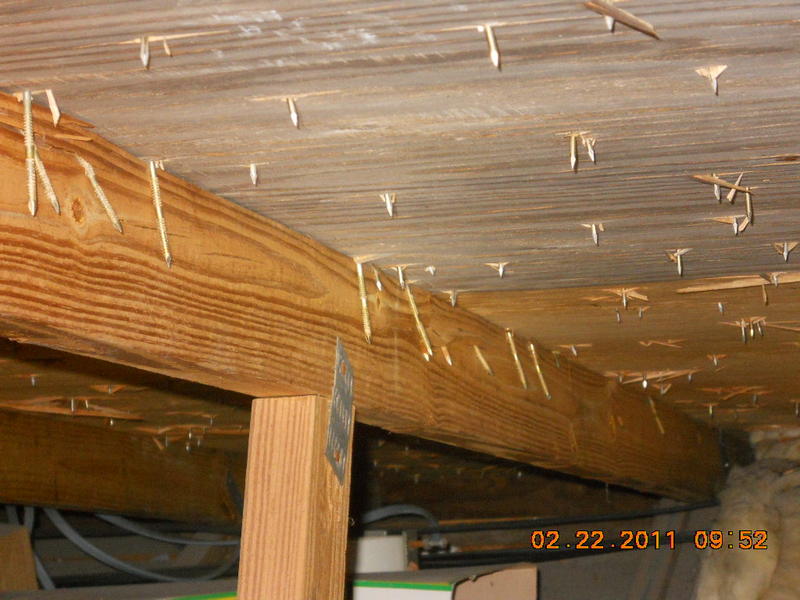

Here is an example of a 2006 HVHZ Reroof, which was renailed “to code” and passed final inspection. FYI
 ![murray 013.jpg](https://global.discourse-cdn.com/internachi/original/2X/c/c53ad5dbeb5bb9957018ee2e1021bde253650ef3.jpeg)
 ![murray 008.jpg](https://global.discourse-cdn.com/internachi/original/2X/d/d9fb777606ff8aee08ee699291d074d5ebfa526f.jpeg)
 ![murray 014.jpg](https://global.discourse-cdn.com/internachi/original/2X/4/46c9cdaad2b519620773120aa24c259e602c7e2e.jpeg)

Because of the sensitivity of exposing an existing home to the elements the building officials accept an affidavit from the roofing contractor that the roof was nailed off to code. So an actual inspection is not done. Some jurisdictions also accept an affidavit for the dry-in as well and in reality a final inspection is all that is done by the AHJ.
Most of the time what I’m seeing is the roofing contractors are using 10d ring shank nails and are not trying to calculate which zones require 4" on edge nailing and simply attempt to nail the complete roof off at 4" on edge and 6" in field
Per form 1802 the max. credit is 6" and 6" so in theory if the roofing contractor can hit the truss with 33% of his nails then the roof wood be in compliance with form 1802. Which means that 66% can Miss and still comply. So unless I see something like the picture in the earlier post in which all nails missed I don’t get to much indigestion

I asked one of the guys at Citizens the question regarding all of the nails missing the trusses. He said, “You aren’t doing a code inspection”. Apparently, no one is!:mrgreen:
I wonder what is going to happen when a hurricane hits and tears a bunch of roofs off that weren’t nailed properly?
