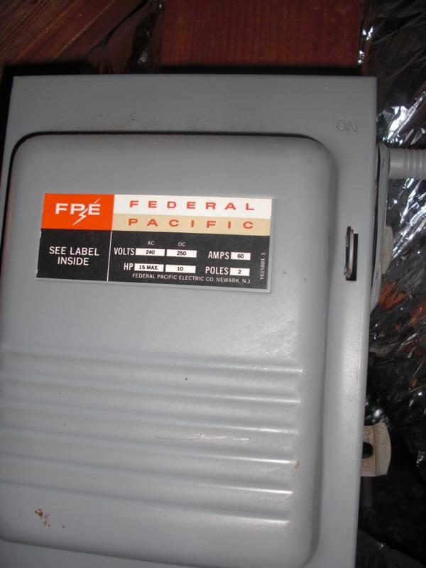

How about a FP disconnect for a furnace? Problem or no?
Why do you think there is an issue with the dis-connect ?
The problems are only with stab-loc.
As Bob said and as far as I know there was never really a problem with FPE disconnect switches.

Thanks Joe - I always point out the FPE (as well as Zinsco and Sylvania) and just explain the problem with them and suggest a qualified electrican examine for REPLACEMENT. An electrican can’t see any more than I can so haaving him look at it for repair is a waste of time. Was just hoping for more definitive info but will continue with what I currently say and do.
