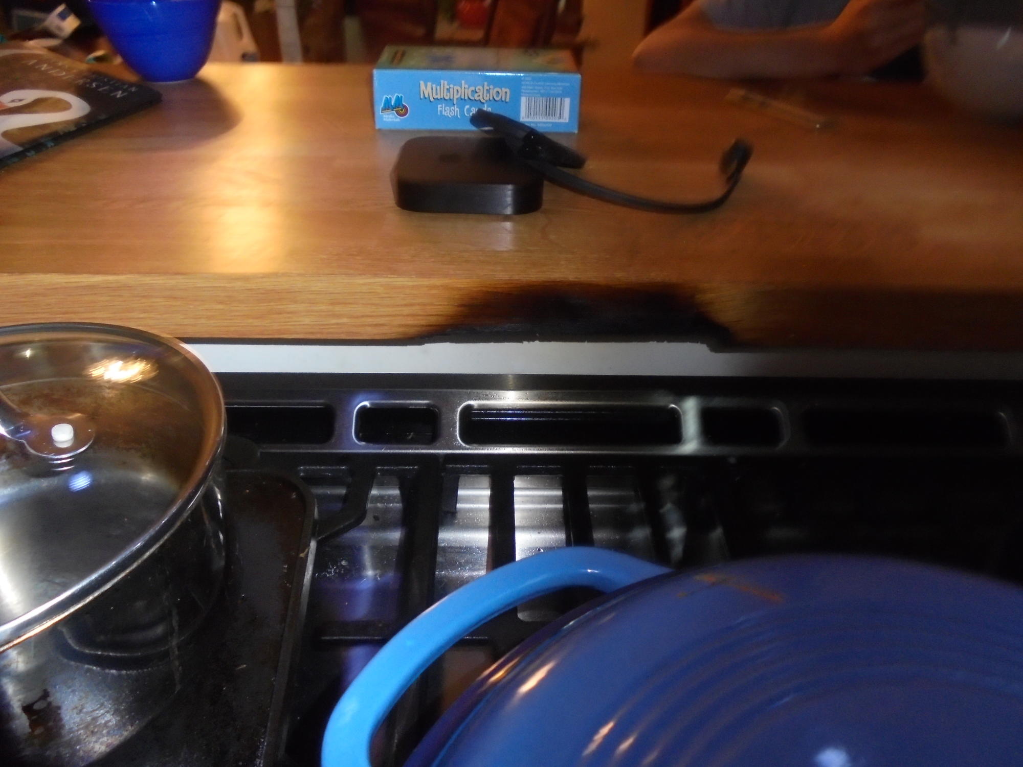

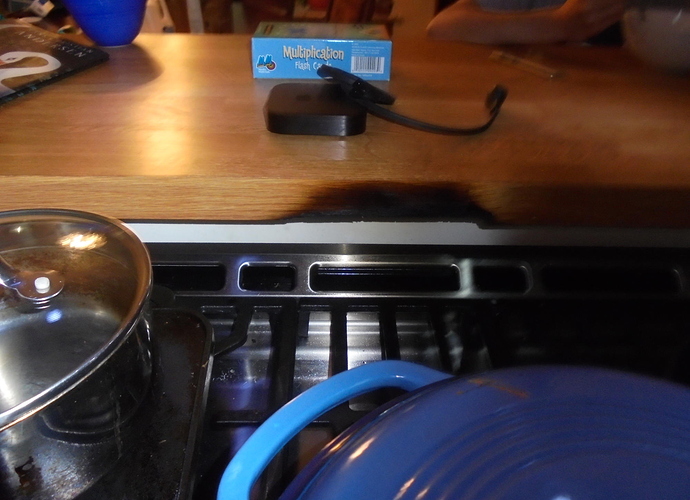

Went to do a final draw yesterday and I could not pass the work so no check to the contractor. Lots wrong at this home but the counter area over the stove caught my eye. Lady of the house says they can only use the front burners.
Also the counter is particle board covered with PSA veneers. They come loose when heated.

Lets see. Wood next to gas stove fire. What could possibly go wrong. Some contractors leave three common things off their job sites. Common tape measure, common level and especially common sense.
The counter top is substandard as it’s not fireproof :slight_smile:
Send that pic to whoever certifies the FHA contractors lol
