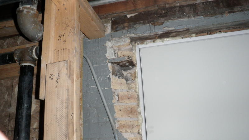

Find the defect, win nothing.
Possibly the ledger board is bolted (or not) to the brick facade along with the service line…
Electric cables clearance and posts/ledger boards connections comes to mind.
Take notice of the lattice that was installed next too the mast head.
Taking the above comments in mind, my simple question is: do you not require a beam under the deck joists in Chitown? From the pics, I cant see one. Around here, thats a no-no, a big no-no.
Yeah the feeders run under the porch and that was caught Jeff.
Chicago has very strong codes that never get enforced unless the city feels like getting to it.
If you request an inspection it takes around 2 months for them to look and of course if you are an owner you will get fined.

How about the one big one…ledgers are attached to the brick veneer.
Jeff
Looks like a 1928 building Jeff.It even has the old battleship grey porch paint left in place along that exterior light conduit.
We have a winner!!!
Yeah, looks like the “flippers” ran their own drop. The splices were not those used by the local utility company.
Woo Hoo I win
This was an old 1923 Masonry building. They allow a ledger board if it is bolted through (which this was).

What is that steel cable draped across the bolts on the ledger.
Do I win ?
1.Electric service not right.
2.Missing door flashings & finitions.
Beauchemin,Marc-Andre :slight_smile:
No, that was the service drop.
The 2nd defect I referenced was the grouping and heights of the furnace vents.
The doors were OK, the just framed them out poorly.
Thats not brick veneer
Yep, full masonry building, old Chicago quad wythe wall. Remember, from 1880 through 1930, there were very few frame houses and buildings built in Chicago. It is a, laregly, masonry city.
Something about a little fire we had in 1871.
Saw the service drop soon as I viewed the picture originally but I meant the steel cable going over the handrail.
Must be part of the messenger.
