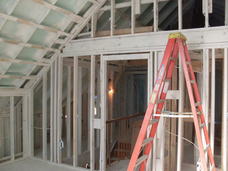

This was found in an attic. No appliances. It appears to be fire damage. Painted with silver paint. Thoughts ??
Charlie

Fire damage. It is painted to mask the smoke smell.

Yep, that it is! At least they replaced the “charred” members. Many times they don’t!

Intumescent paint, sold by sherwain williams and called white pigmented shellac or an equal and this job looks like it was done half fast. 🙂
It should look like this;

Marcel, what is your opinion as to how they painted the sheathing and replaced all those rafters afterwards. I hope this home has a reroof that included renailing of the deck after those new rafters went in.

Brian, the only thing that I can comment on from the pictures is that it appears the intumescent paint was applied before the shingle replacement.
I am assuming the the roof covering was replace by evidence of the splintered plywood from the nails above.
I do not know what product was used, but appears to be showing inadequate coverage.
I would have done all the necessary repairs first and then sprayed all areas that were charred or smoke inhibited.
The product that I mentioned (White Pigmented Shellac) would drive you out of the building if you do not have a respirator. Lasts about 12 hours. Very potent stuff.
It works.
Hope this helps. 🙂

Interesting 2 pictures. Really hard to comment, could be several scenario’s. Bad restoration repair! Would like to see more pictures or get more info.
You can assume a fire. Minor fire not intense. Your first picture toward back shows an area of raw wood, probably CDX sheathing. No char! The ridge, and rafters on left side of roof show lite char. Not sure why or how the rafters on right side where replaced, that appear to be new. Smoke and heat go up. You would assume that if the right side rafters needed replacing the ridge and rafters on left would need replacing.
The CDX sheathing shows lite alligatoring(barely).
All speculation without more info.
If there was an actual fire, typical kiln or binz type paint is used and completely covers all the framing and sheathing. Generally, spray applied with a paint sprayer. It covers the fire odor. I would assume you can smell some odor of smoke. You would only see white and not the mess we see in the 2 limited pictures.(mess meaning, incomplete and and not adequate coverage of the assumed material char.)
If you want to, not required, recommend to your client they contact a certified/licensed fire restoration contractor to evaluate.

Fire Damage, Disclaim it.
Ask for documents certifying past repairs.

Poor restoration. Rafters replaced only at one side. Moisture content @ remaining framing? Complete moisture loss is possible, with potential resulting structural integrity defects. Be carefull with the wording in your report.
