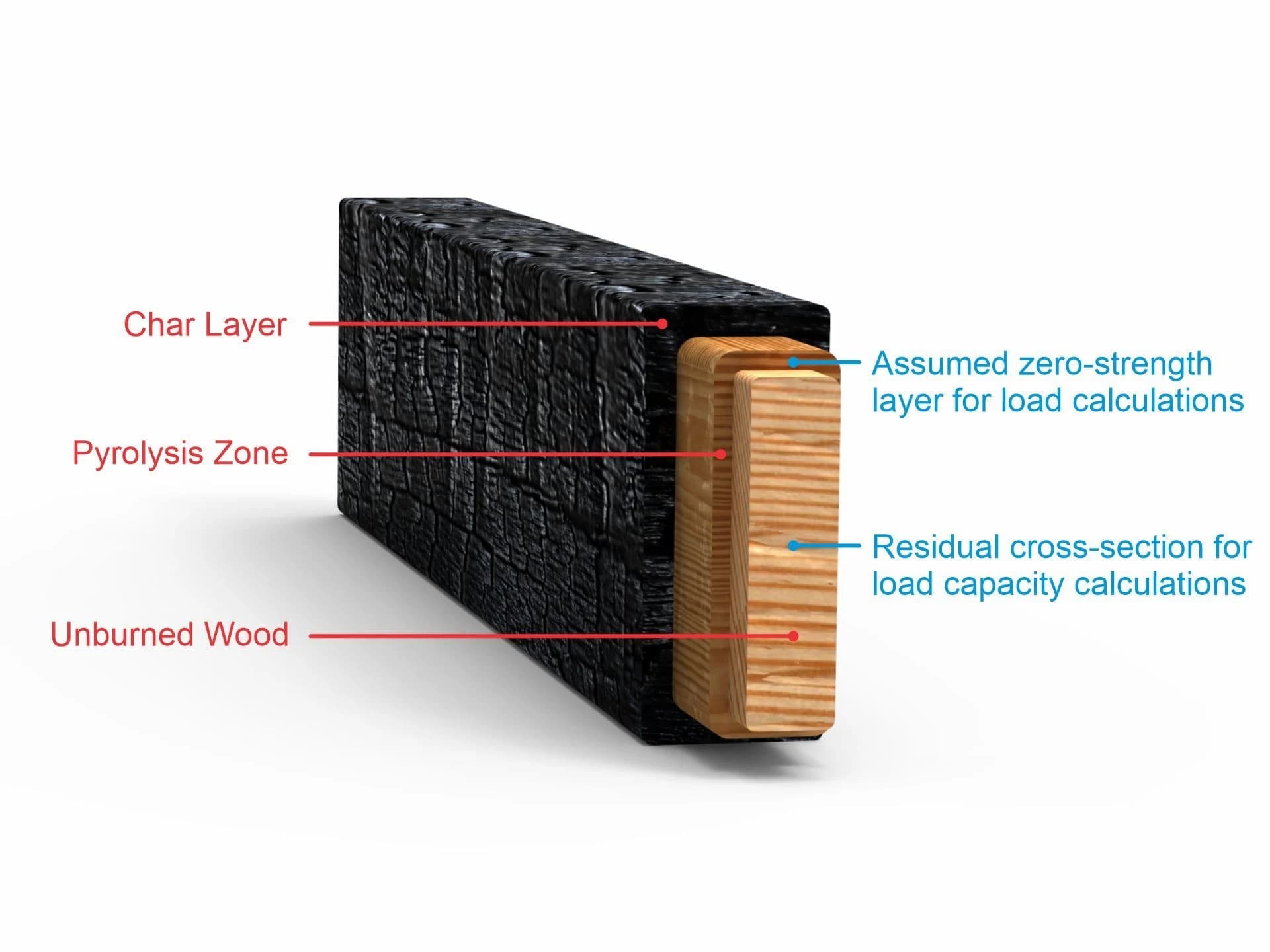

Here is a nice graphic by @rmayo and he may weigh in.
Just one thing to consider when looking at fire damage.
 ![image](https://global.discourse-cdn.com/internachi/original/4X/d/d/8/dd8dae20b17f41e39e48c58709b9b02567a162d5.jpeg)

The white paint just encapsulates the smell. Any charred members with more than 10% section loss should be removed.
