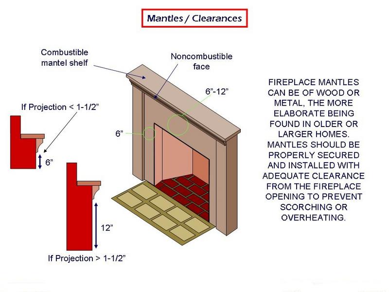

What are the requirements for the materials of the facing of a wood burning and gas fireplace.
One home I recently did just had drywall up to the firebox/glass doors
Nice reflection of myself!!!

David,
Most gas fireplaces are low clearance fireplaces and the drywall outside the firebox is not an issue.
Wood fireplaces are a whole different situation…
