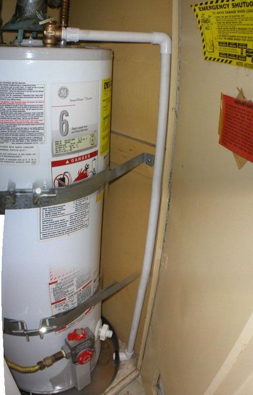

First time in 11 years…Never seen this before

Well… what the heck else was the hole in the drain pan for… good match, right? 🙂
Did they re-use an un-coated brass gas line? What happened to upper and lower thirds… the list can go on. And it usually does, as that brand of water heater is sold at the big box stores…
Do-it-yourself!!

Yes, old brass gas line, no trap in line, no screws on vent had duct tape instead, draft hood not seated properly, blocking missing, interior location needing a watts-210 like you said on and on…

Looks like standard PVC.☹
Saw the picture and thought you meant the earthquake straps.

No markings, letters, numbers. It looks like poly B?
I would be concerned about the temperature of the steam that will radiate onto the product.
Will the fittings fail and some one is in the room at the time.
I would write it up HARD AND FAST IF NOT COMPLIANT:)
[http://www.3dplumbing.net/ontplumbing/hot\_water\_tanks.htm](http://www.3dplumbing.net/ontplumbing/hot_water_tanks.htm)
[http://www.grassroots.ca/homeowner\_help\_articles/hot-water-heaters.php](http://www.grassroots.ca/homeowner_help_articles/hot-water-heaters.php)
And lastly.
[http://www.waterheaterblast.com/](http://www.waterheaterblast.com/)
SUSPECT: TRV; Relief value drainage plumbing assembly.
1.
               temperature relief valve with a temperature sensing element located within the top 150 mm of the tank and designed to open and discharge sufficient water from the tank to keep the temperature of the water in the tank from exceeding 99oC (212o F) under all operating conditions, or
2. See if that plumbing product is COMPLIANT. Does the heat effect the glue or fittings and pipe. The steam pressure will be eminence if the TPV it is tripped…
3. SUSPECT::twisted:
4. Just an opinion.

Reason of the post was the T&P line

The plumbing assemble and exit for the t&P pressure value return to exhaust the steam in close proximity to the gas line shutoff and manual emergence shut off valve.
Joints between polyethylene plastic pipe and tubing or fittings shall comply with Sections 605.20.1 through 605.20.4. [http://http://www.archive.org/stream/gov.ct.plumbing/ct\_plumbing\_djvu.txt](http://http//www.archive.org/stream/gov.ct.plumbing/ct_plumbing_djvu.txt)
[http://education.nachi.org/show.php?course\_id=41&element\_id=798](http://education.nachi.org/show.php?course_id=41&element_id=798)
flue shut-offhttp://education.nachi.org/show.php?course\_id=41&element\_id=801
A boiler should be equipped with a pressure-relief valve with a minimum rated capacity for the equipment served. A boiler operates at a maximum water pressure of 160 psig, and at a maximum water temperature of 250° F (121° C). A pressure-relief valve should be set at the maximum rating of the boiler. \*\* Discharge should be piped to drains by gravity to " within 18 inches (457 mm) of the floor or to an open receptor."\*\*
[size=2]I see a deficiency in the installations.
InterNACHI:) [http://education.nachi.org/show.php?course\_id=41&element\_id=788](http://education.nachi.org/show.php?course_id=41&element_id=788)
