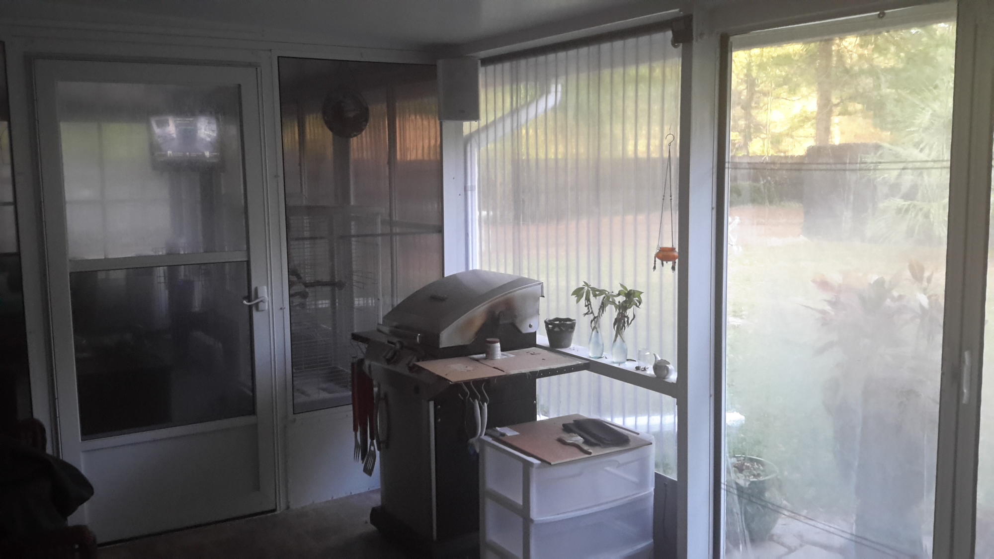

Hi,
Moisture can move in and out of a home in many different ways. Some, most people won’t even think of. In these pics you see a bathroom vent fan duct that runs over to the soffit, but does not vent outside. The other pic shows all of the moisture that is being vented to an enclosed screenroom from a dryer in the winter. Most people do not realize how much water vapor comes out of these ducts and vents. Over time and under the right conditions this moisture collects on building materials in attics or rooms and mold begins to grow and consume the building products. In some cases this becomes a health concern for the occupants. It is very important that these items vent to the outer envelope of the home.
