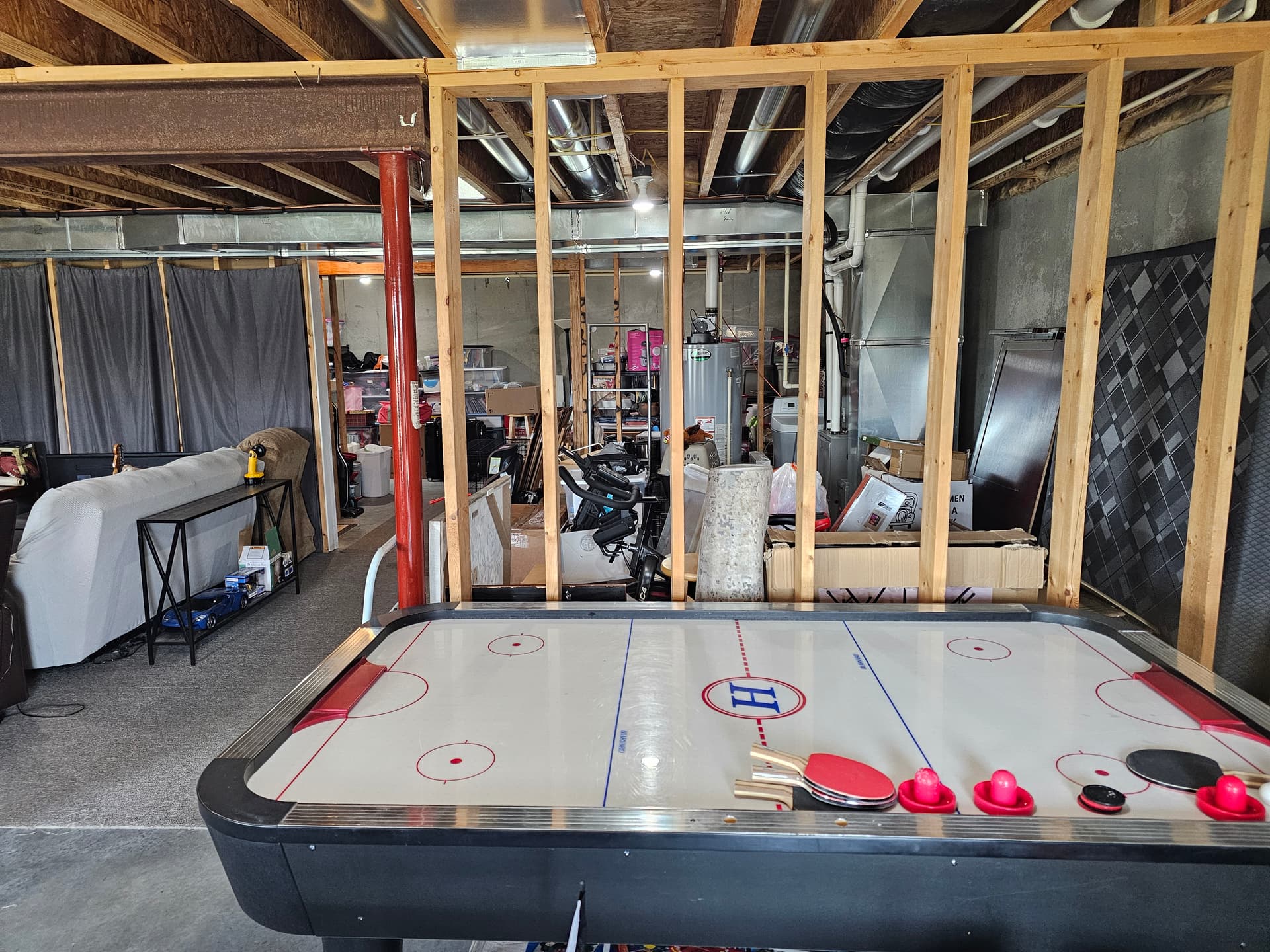

So are these flaps on the columns considered an appropriate permanent attachment to the I-beam?
State code here only specifies: “All columns shall be positively attached to the beams they support using clips, straps, or saddles.” Flaps appear not to fall in any of these categories.
(And yes, I know that its quite strange not to continue the I-beam all the way to the opposite end of the foundation.)
From what I can see, that complies around here:

Thanks, I had heard that bolts needed to be added through the I-beam to the holes in the bottom. However, I haven’t found a source that backs that up.
As @lkage stated, they’re compliant, I see them all the time in my area as well.
Non-issue.

If those flaps are not welded I would;
Recommendation: Consider evaluation by a qualified structural engineer or local building official to confirm compliance with applicable codes.
Attached is a YouTube video from the manufacturer on column installation. On I-beams bend the tabs and bolt to the I-beam. On wood beams they want you to add a saddle bracket and again secure with bolts.
Same here. I seldom see them attached with additional fasteners…
This is great, manufacturer recomendations are king. Thank you for finding it!
Around these here parts, the screw/threaded end is at the top, 99% of the time.

I don’t like how the steel is being used in the mostly wood 2x6 load bearing wall. The opening is not secured sufficiently along the axis.
No flaps. Threw steel fasteners are required if I am not mistaken.
Not to go off thread but the lumber atop that steel beam does not look like it is secured properly. No nut and washer for the wood-nailer above the steel beam.
The forced air return pan can leak below the top plate.
Are blocks missing in the floor joists to prevent rotation/movement?
I concur, Lon. Here to. But it does not mean it is right.
Typically the adjustment screw and handle is located at the bottom and are imbeded in concrete to prevent rotation adjustments. Randy’s video is correct. Once the concrete is poured the bottom of the column becomes locked in concrete while the upper portion flanges temporarily secure to the lower I beam while nuts and bolts permanently secure the column in place at the top.
In this case there is a gap between the wood and the steel beam. There should be 2 saddles atop the gaps, One on the left and right side gap, to stiffen the complete bearing wall in my opinion.
True that it is not manufacturer’s instructions, but since our AHJs allow it, it becomes “right”, and I do not write that up. Around here, it is more common to see the welded flange bolted to the pier instead of imbedded in concrete. I cannot remember seeing an upside-down column failing because the threaded end is on top.
