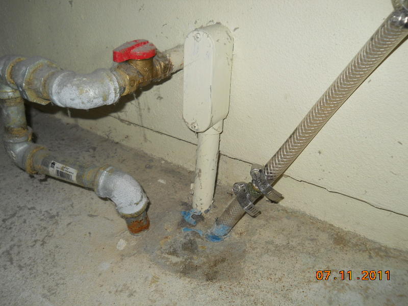

This line was added (apparently) to provide water service to an ice maker on the other side of this exterior kitchen.
Problem or not?
Problem or not?
Not allowed here and neither is galv piping for gas however.
Normally, isn’t gas piping sleeved through concrete to allow gases to escape should there be a leak at some point?
So yes, I think I’ll call out both.

No its sleeved to prevent the concrete from corroding the metal piping and to prevent soil expansion and contraction from moving the piping
