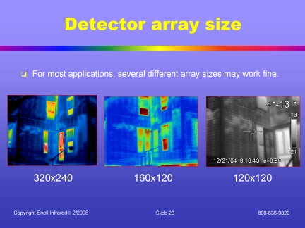

Went to a trade show put on by Flir yesterday. They had both Flir B-50 and B-60 present among many others.
The B-50 goes for $5,995 / The B-60 for $7,995
To be honest myself and many others could not see any significent difference of the view through the lens, on the screen, etc
The B-60 has 180 x 180 and 32,400 megapixels.
The B-50 has 140 x 140 and 19,600 megapixels.
Both look and feel identical. I think for a HI the B-50 would do the job.

The difference in array size can be significant, especially when you are pushing up against the limits that any camera has. But if you are working well within those limits, as many in HI are often doing, then the difference is surprisingly small for much of our work.
See the attached slide (from my webinar on Buying an Infrared Camera) showing images taken with three popular size arrays; please note these were taken at different times so some variations is due to changing conditions rather than different arrays.
The bottom line for buildings work is can you _easily_ resolve a 2" stud at the typical working distance. If you can, then you can probably use the camera, although some defects are smaller than that dimension!
Remember too that pixels and the field of view (FOV, or overall size of the image you see) are inter-related.

> To be honest myself and many others could not see any significant difference of the view through the lens, on the screen, etc
This is a side by side test of a hot coffee cup.
The scan on the left you can see three flowers painted on the cup. You can not see them as well on the right.
Why would you need this in a Home Inspection?
But as John said, when you push the limits of the camera (temp, distance), that is where it will show up. Not by looking through two cameras viewfinders.
This is why it is important to know the limitations of the equipment you are using.
