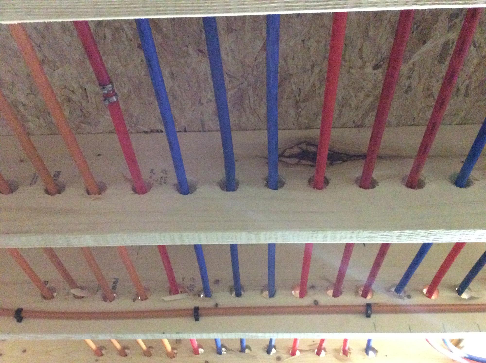

floor joist inspection
Inspection of this floor joist located on the first floor of a two story home shows that the holes drilled are less than 1/3 the depth of the member. The holes are not within the top 2 inches, or the bottom 2 inches of the member. The holes are also spaced 2 inches or greater apart. This meets the local building code standards and is satisfactory.
