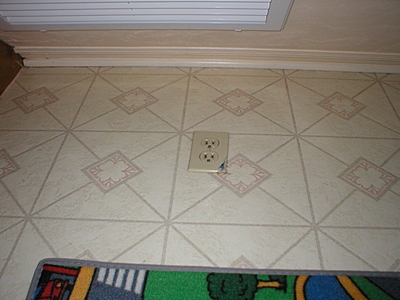

called this one out last month.
![jsw_p1240087.jpg](https://global.discourse-cdn.com/internachi/original/3X/0/9/093741f1db7dea445fa316a6b367a4b20dcf4348.jpeg)

GREAT call Michael…A fire hazard waiting to happen…
Have you GUYS ever thought of the THOUSANDS of lives you guys probably save a year…Great JOB !
