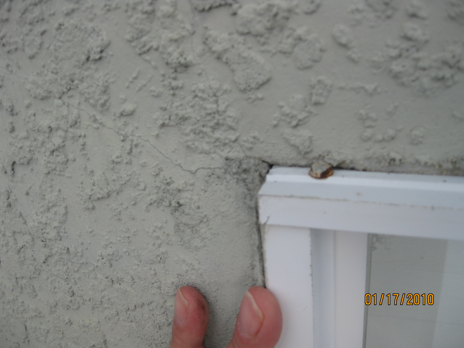

This post is to submit an essay for the Florida Mold assessor coure.
Controlling moisture is the key to controlling mold growth. In the photos attached, you can see water intrusion around one of the windows in the home. The water intrusion was due to the top of the window not being sealed to the stucco finish on the exterior of the home (shown in the second photo). Mold growth is already beginning and will get much worse if the problem is not resolved.
