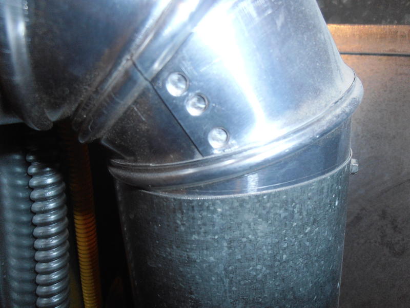

The flue pipe in these pics appear to be connected backwards. Is this okay?
clambert2
(Charles Lambert)
2
Nope. CO leakage at joint
If it’s on a type 1 appliance (negative vent) it doesn’t matter.

5
Good catch.
Recommend at least sealing it but on the bright side they will not see condensation streaks at the connection.
